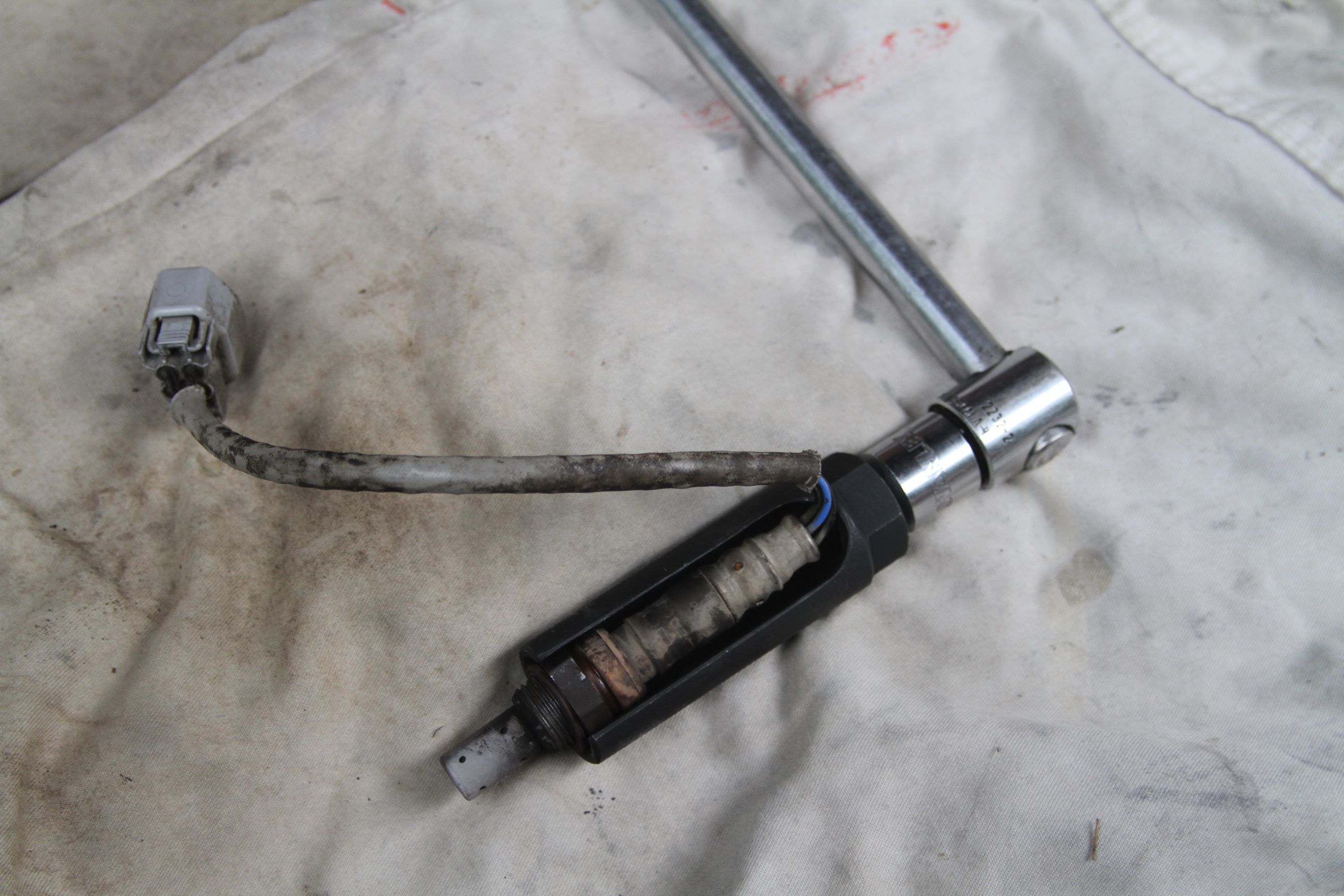

I am posting this in case it is useful.
I needed to replace one of my upstream O2 sensors. Very uncharacteristically for Jaguar, you can actually get reasonable access to them!

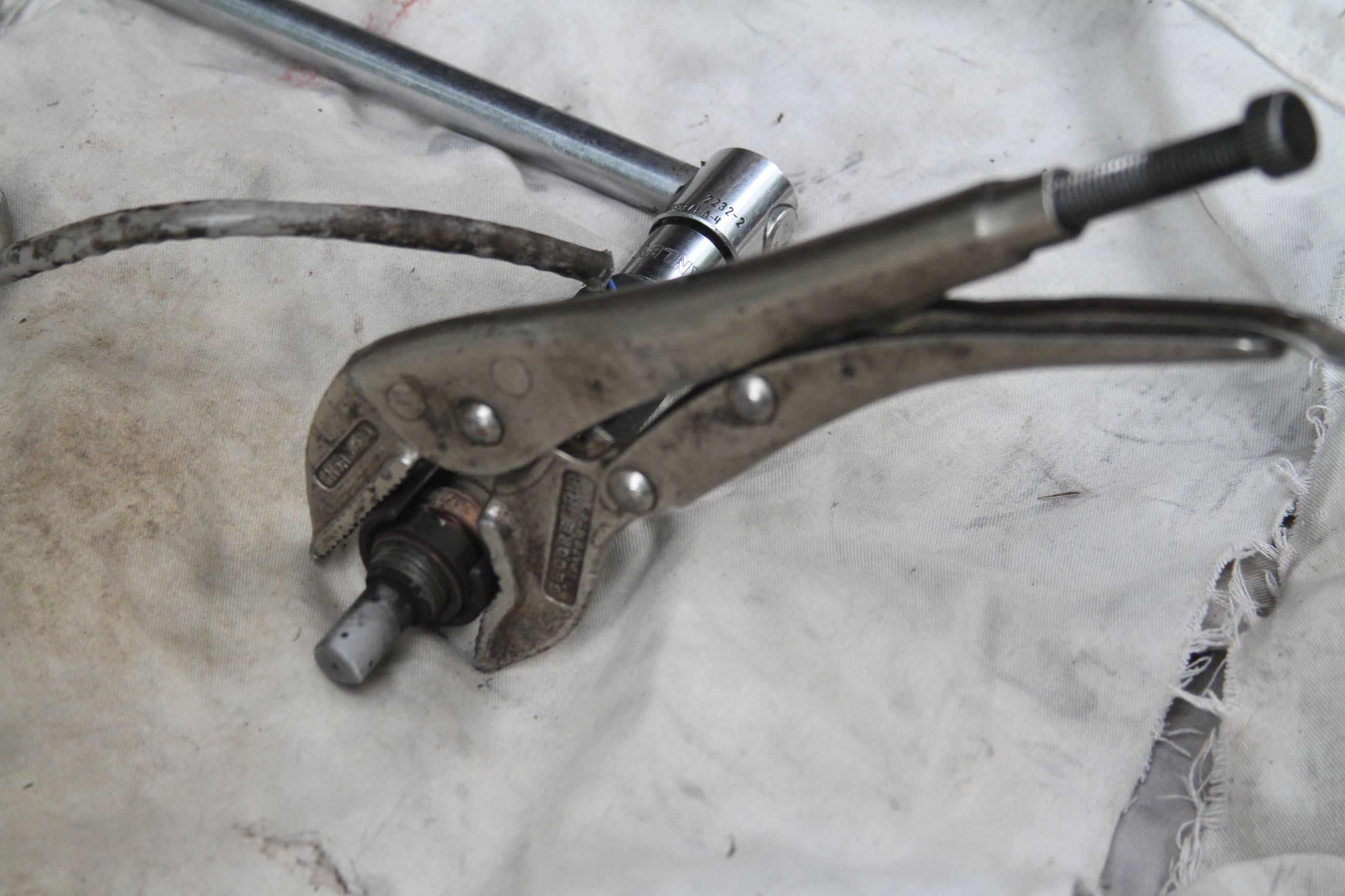

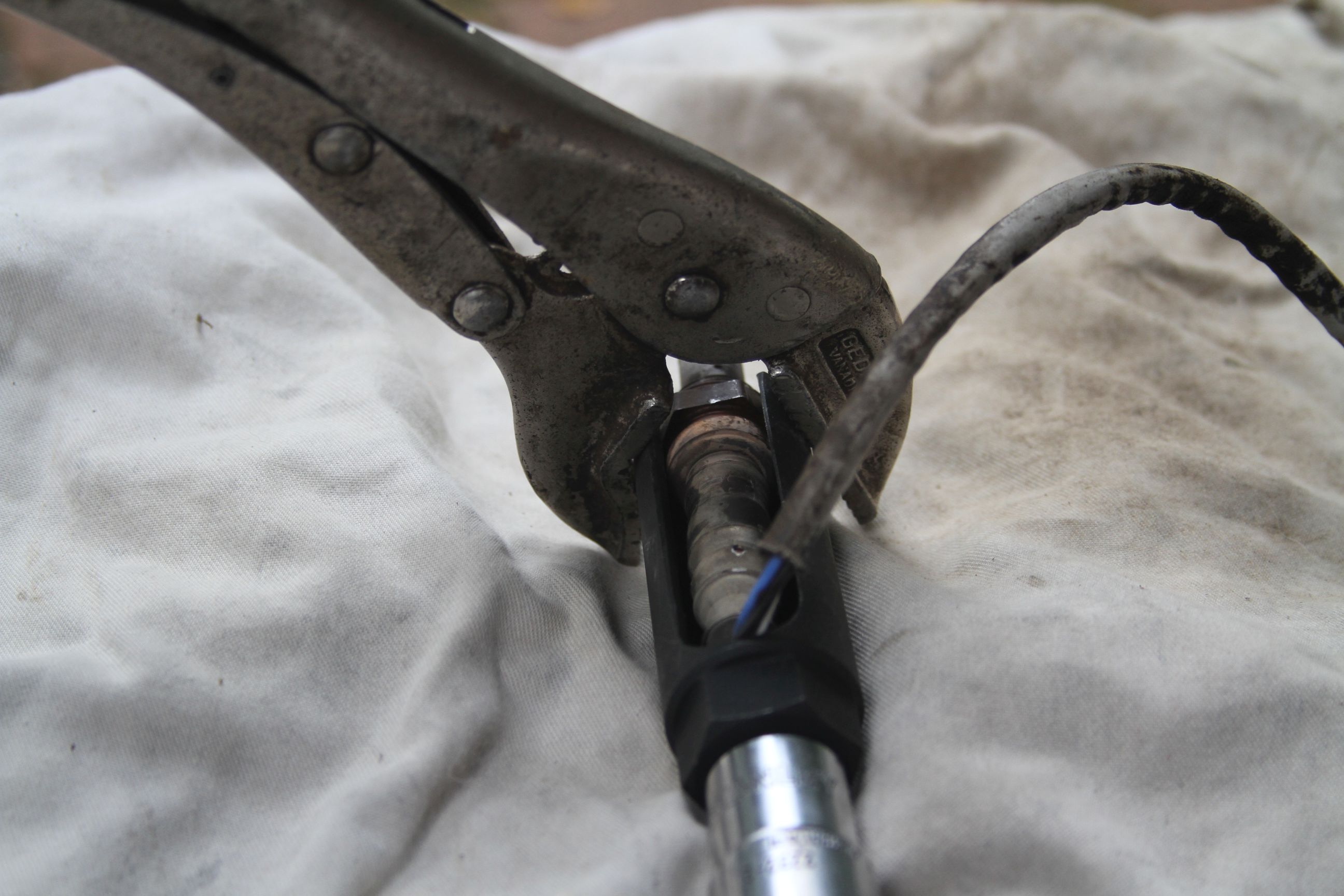

I decided to do the right thing and purchase an O2 Sensor socket. Despite having the 'correct tool for the job', as I was attempting to loosen the old sensor, I could feel the socket spreading under the load. It was fairly obvious that, if nothing else, I was going to lose skin off my knuckles when the whole thing slipped.
But there is a bit of space, so I got out my trusty vice grips and clamped them over the socket, as shown in the photos.
The result was no springing, no lost skin off knuckles and a nicely removed sensor.
Attached Thumbnails Upstream O2 Sensor removal on S-Type-o2-socket-1-halfscale.jpg   Upstream O2 Sensor removal on S-Type-o2-socket-2-halfscale.jpg   Upstream O2 Sensor removal on S-Type-o2-socket-3-halfscale.jpg   Upstream O2 Sensor removal on S-Type-o2-socket-4-halfscale.jpg
