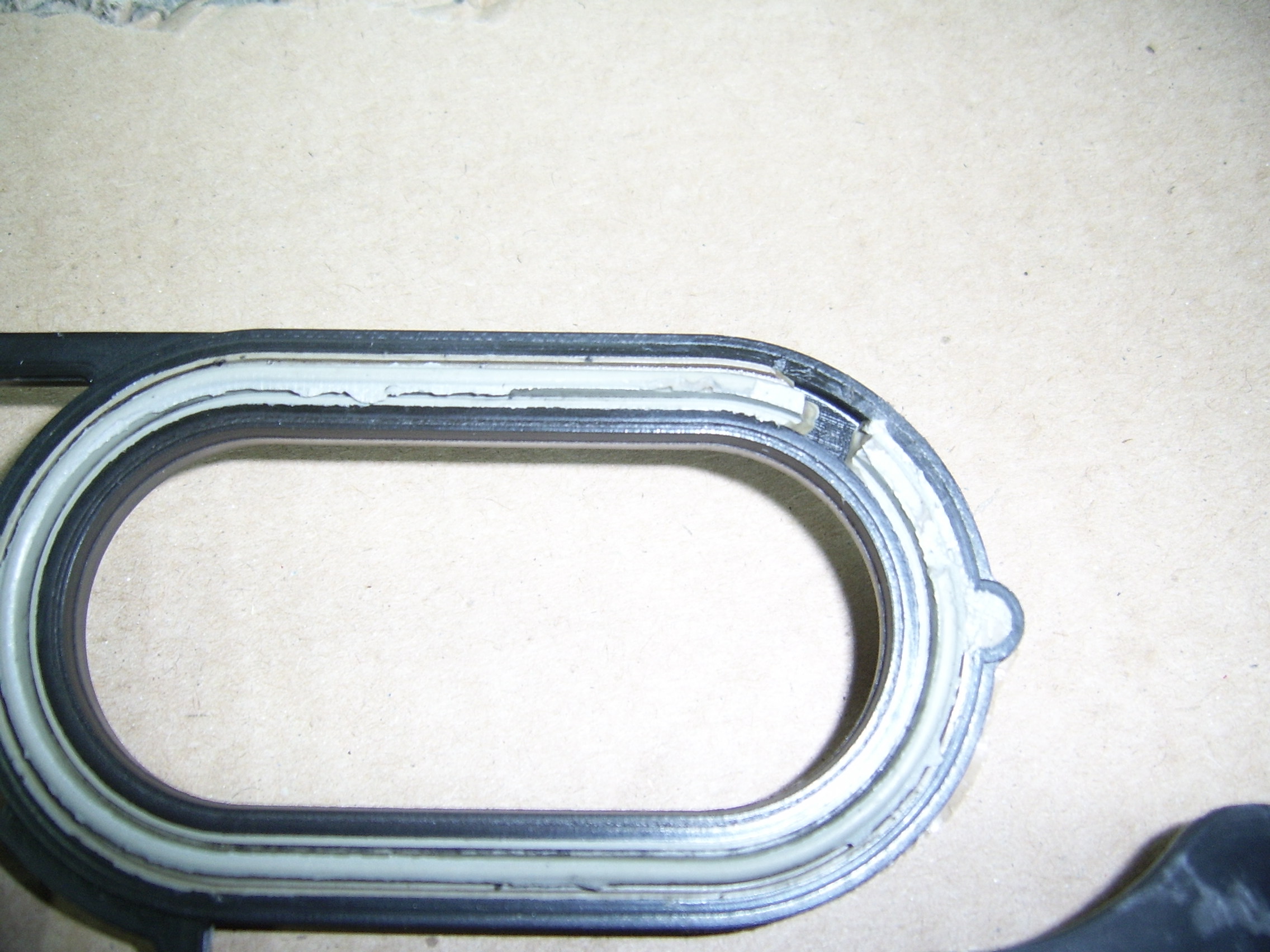

Upper inlet gaskets removed from the packaging. Looked once more at the "old" ones, coz since the hose job the car has done 3000kms, and maybe they are still OK. HAHAHA, wrong as you can get. I reckon they are the originals, and closer inspection found pieces missing, all on the top side. No idea how this could have happened, as a scraper is not needed to remove the manifold, or the gasket unit (these are the earlier one piece gaskets), which simply lift one as one unit.
Photo shows one of the piece missing, and obviously the reason for the strange running.
