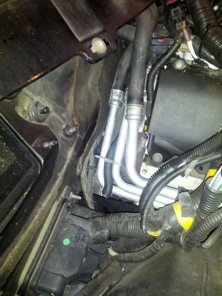

Originally Posted by bfsgross
You can view the EGR and tube by removing the cabin air filter box (not a biggie).
dunno how i missed this post!
i had the cabin filter box removed to take a look at the egr and i also plugged the coolant lines that go through the egr and TB. even with that box removed it's tough to get at the egr

yesterday i took her in to the muffler shop and had them fix the exhaust leak at the manifold.
Happy to say that she is back to normal! No leak and the fuel trims are back to baseline.
thanks JagV8 and bfsgross for sticking with me through this complication!

Regarding EGR:You'de also remove strut tower cross brace and wiper cowl. Happy she's doing well.
