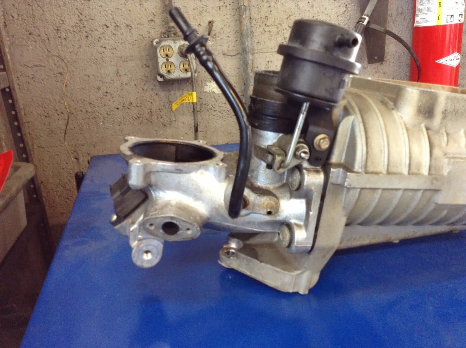

Here are some pics from a forum member (Sorry I forget who) that show the back of the engine and the lack of access.

In the fourth photo of the induction elbow, is the boss with the finger size hole and two bolt holes opposite each other a water inlet? I just can see what the heck could be causing a vacuum leak from below the pb nipple.

THAT IS THE EGR MOUNT.
