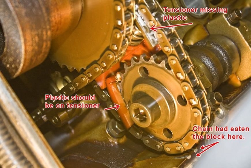

Listen to NBCat as what he says is no joke!
Here is where it will progress if ignored. This is a 3.9L Lincoln LS engine but it is the same engine family as the Jaguar 4.0L/4.2L V-8's.
Also note the dark staining inside the engine a sure sign of lack of oil changes too! The oil has been baked into the Aluminum.
Very glad I looked at this posting. Didn’t realize we have plastic tensioners on the 4.2L’s, as well as this sort of failure.

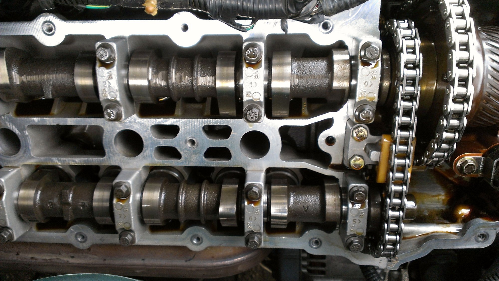

Likes: 2,983
Here is an example of an AJ28 with the updated secondary timing chain tensioner fitted. As can be seen in the photo, the body of the secondary tensioner is metal, however the slider that contacts the timing chain is plastic. I have seen the plastic separate from the tensioner and fall off allowing the secondary timing chain to become loose.
Old Nov 30, 2023 | 04:51 PM
NBCat's Avatar
Posts: 6,068
Likes: 2,983
Originally Posted by scottjh9
I thought at some point jaguar used metal tensioners at the factory. Is this true and if so when
Yes, the factory did switch to the metal bodied tensioners in early 2002 on the 4.0 litre engines. All the 4.2 AJ33/AJ34 engines had the metal tensioners installed at the factory.
