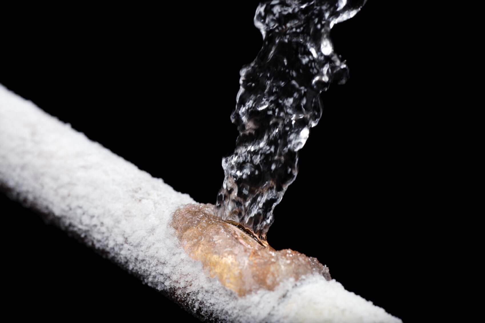

Originally Posted by Mikey
I don't recall any hose or pipe bursting unless there was considerable heat involved.
You mean like this?
Old Nov 15, 2014 | 12:35 AM
  #102
Mikey's Avatar
Joined: Oct 2009
Posts: 11,057
Likes: 2,272
From: Perth Ontario Canada
Exactly! Had the pipe/hose been kept at a nominal temp of (let's say) 10 degrees, that never would have happened irrespective of pressure.
