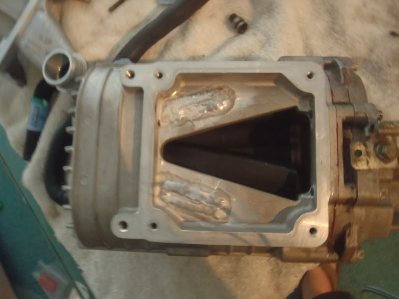

The supercharger is much louder, I would guess its to the point where other motorists mite think there is some thing wrong with the car.
the heat from the weld warped the surrounding area which caused the rotor to bind. it took more work then expected to finish it up

I had some repairs that involved the SC to come off. While it was off I figured its a good time to swap out the bearings and clean it up. I saw some posts on closing the ports also so I figured I would give it a try. I was to afraid to use an epoxy in case of a vibration making some come lose. But a less hot way would be best, If I knew it would warp I wouldn't of welded it closed. Maybe thread some screws part way in some where on the case that can hold a plate to cover it? Or spot weld a cover to reduce the heat.

Spot weld a cover might be the best bet. It really wouldn't need to be a 100% air tight seal really, would it? Just enough spots to make sure the cover will stay on there securely and I'd think that would accomplish the job without the heating issue of a full on weld-fill. I'd also be a little sketchy on epoxy but there are some pretty strong ones out there these days.

From reading the cobra forums, they say you see a .5-1psi increase

What might work without welding is to fabricate a thin aluminum plate that duplicates the floor of that chamber and has an opening matching the main opening, but no openings for the bleed ports. Slather jbweld on the plate and glue it to the floor. The most that could happen if the plate comes loose is rattle around in the chamber as it is too big to go in either direction. If the plate extends up the sides like a "U", it cannot even do that as the top cover will hold it down with mechanical pressure.
You could also have openings for the silencer ports, but smaller ones biased towards the sides.

In the spirit of staying on topic I have seen before and after dynos on Cobras that didn't show any increase in anything but sound. Also spot welding on alternating sides and allowing time to cool helps when working with aluminum.
