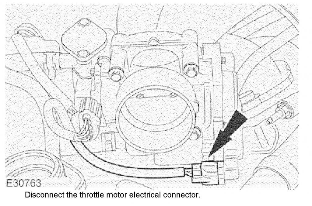

Someone needs a new monitor or if you're like me, new eyes. I can make out the "TPS connector after sealing..." comment, but it is a bit blurry. The TPS plug is finicky as I discovered. I had a throttle body failure which after being replaced led to a second throttle body failure a few weeks later?!?! At least that's what the codes stated. Puzzling until I pulled the engine cowling off and gently moved the TPS harness while the engine was running. Went into limp mode immediately. So I gently pulled the TPS plug off and very carefully squeezed together the female ends of the harness plug to tighten them up and carefully re-fastened it. Put the cowling back on and it has worked perfectly since. It's been a few months now without incident. It only cost me $2,298.25 for an unnecessary throttle body replacement. Oh well.

The plug with the two wires is the motor that works the throttle plate. The connection with the four wires goes to the throttle position sensor. The two outside wires are (+) and (-) from the ECM computor. The two inside wires read the throttle position and sent that info back to the ECM. The four wire connector is the big money maker for the dealers. The wiring should be checked before changing the Throttle Body. The lock button releases by pushing it inward. I sprayed mine with WD-40 to get rid of any moisture and then disconnected and connected it several times to fix the connection. It got rid of my P0121 code.

Good Catch. Don't know if it's how it works universally, but on my PC, JTIS puts the text on the right, with pictograms on the left, one at a time. So a list of 6 or 10 steps and one pic. As you click the arrow next to a step, you get the pic. I "thought" step 2 (disconnect the throttle position sensor) was selected when I got this picture. So I called it the TPS.
