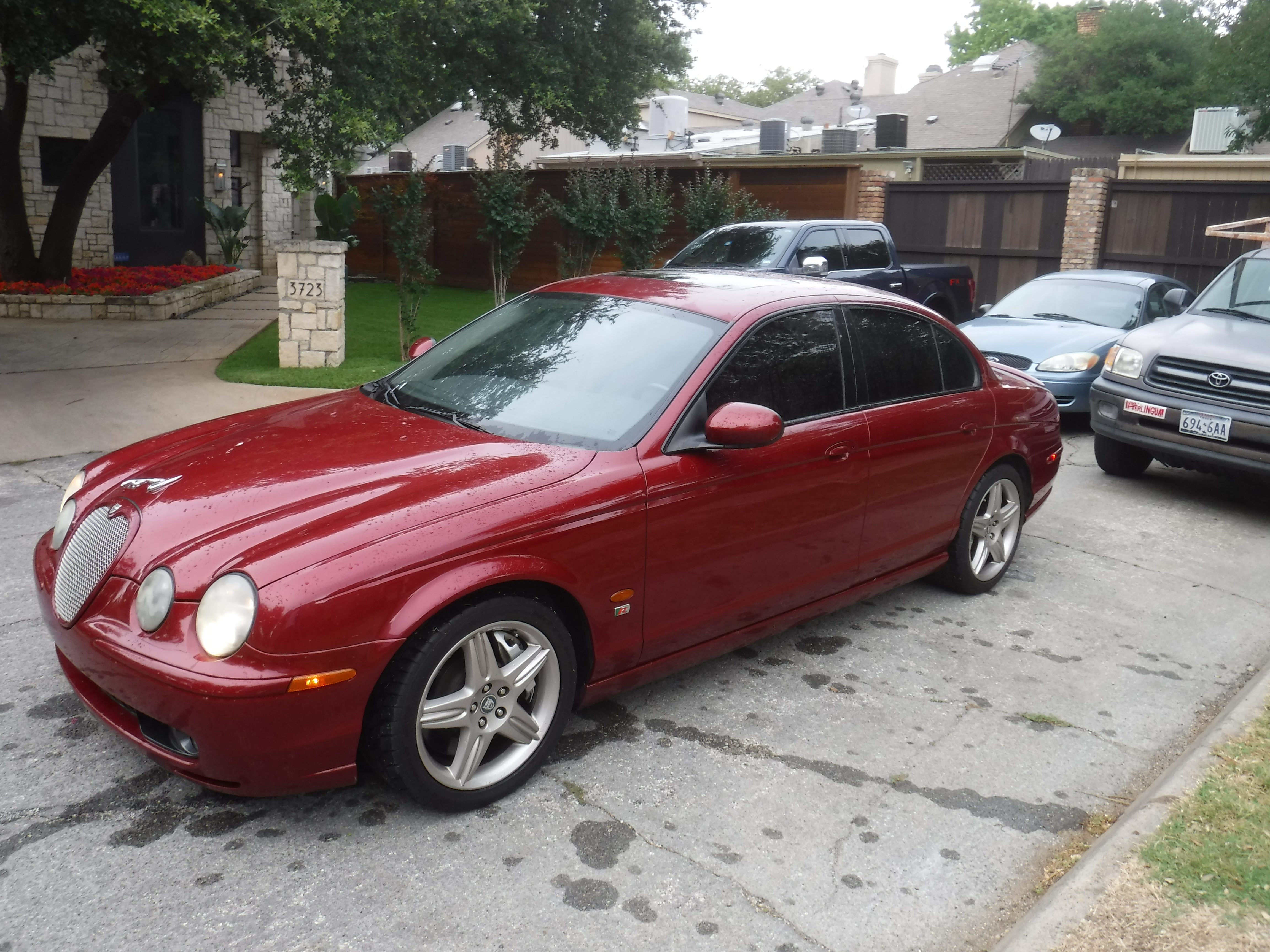

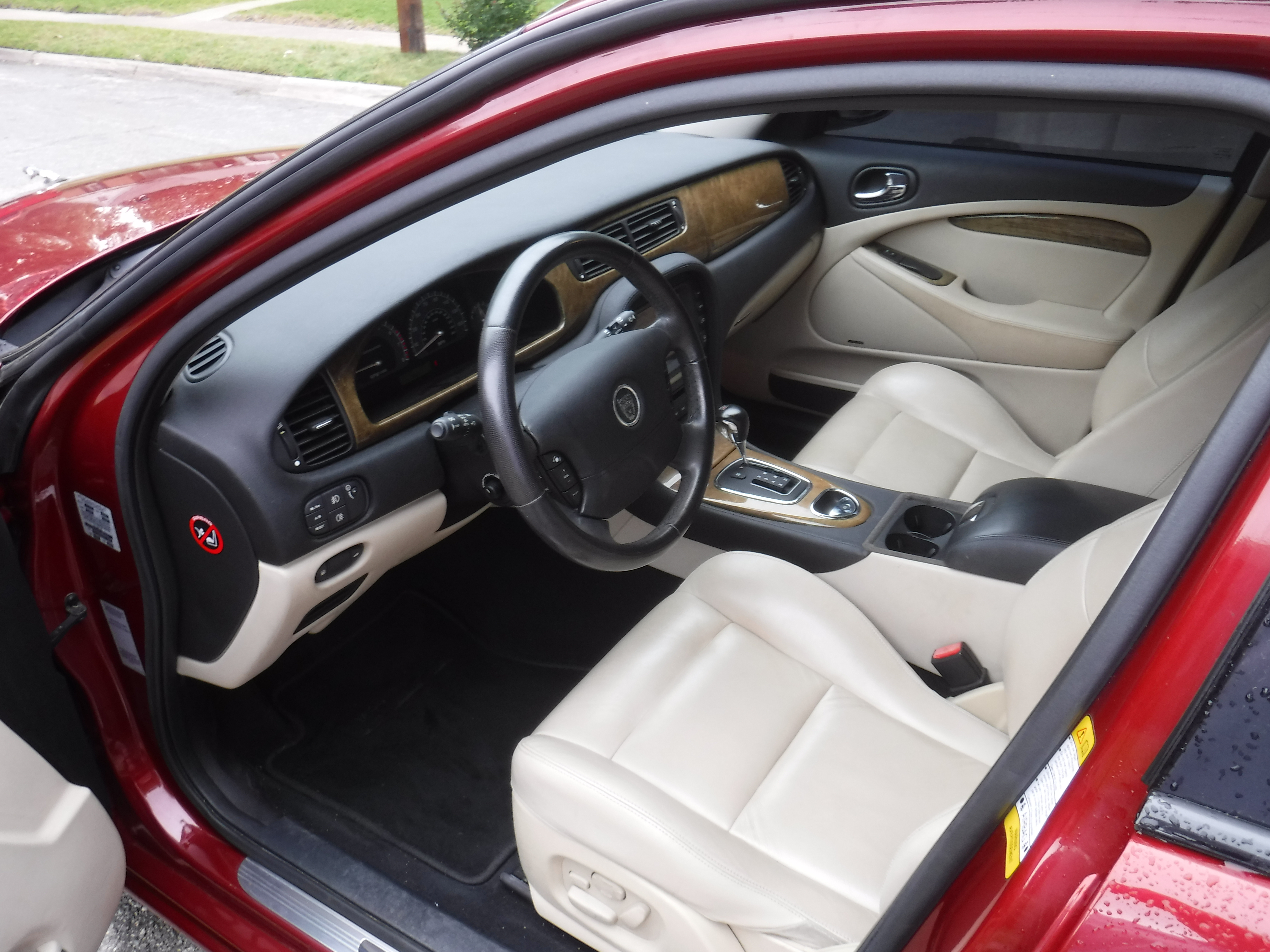

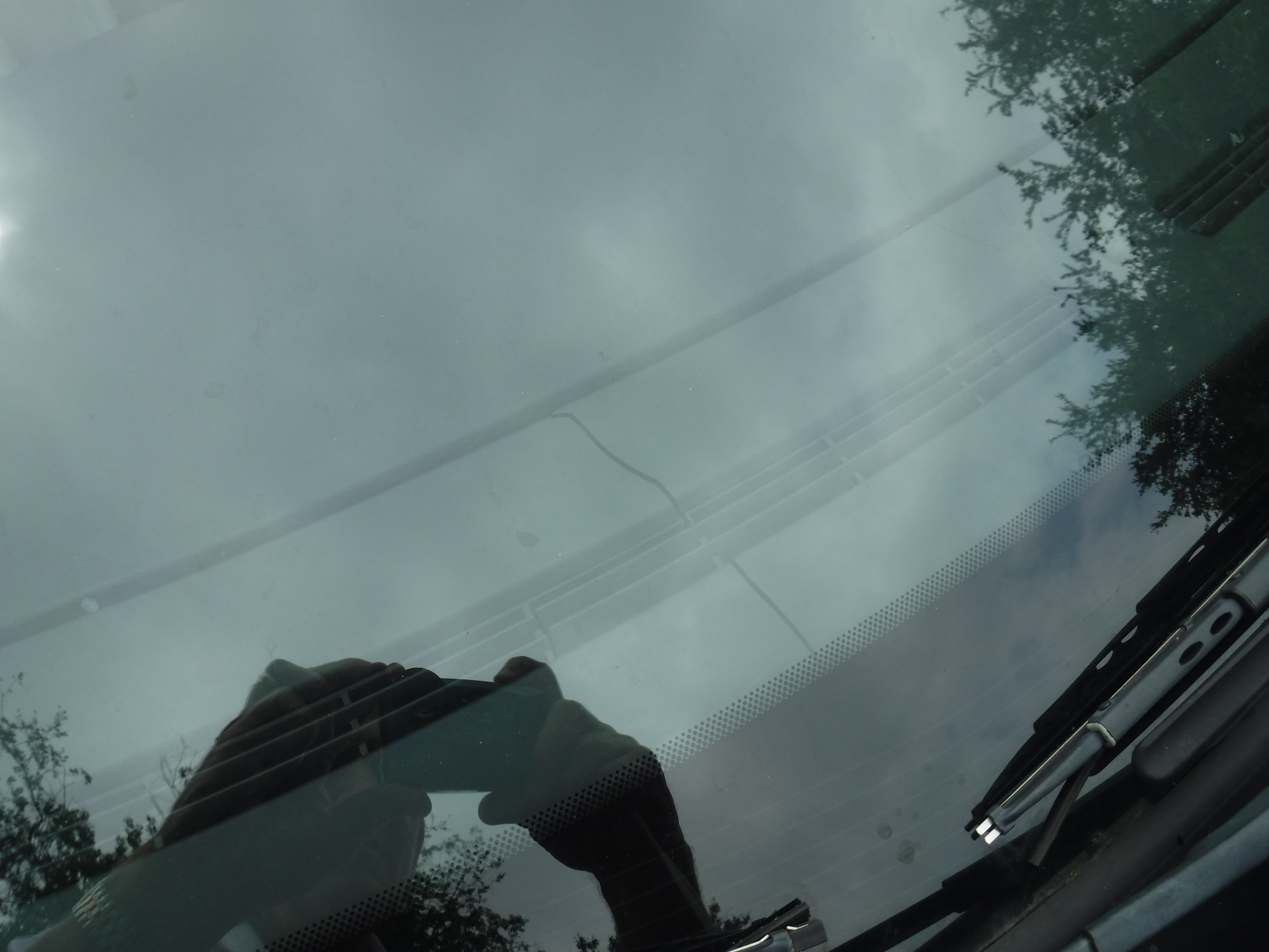

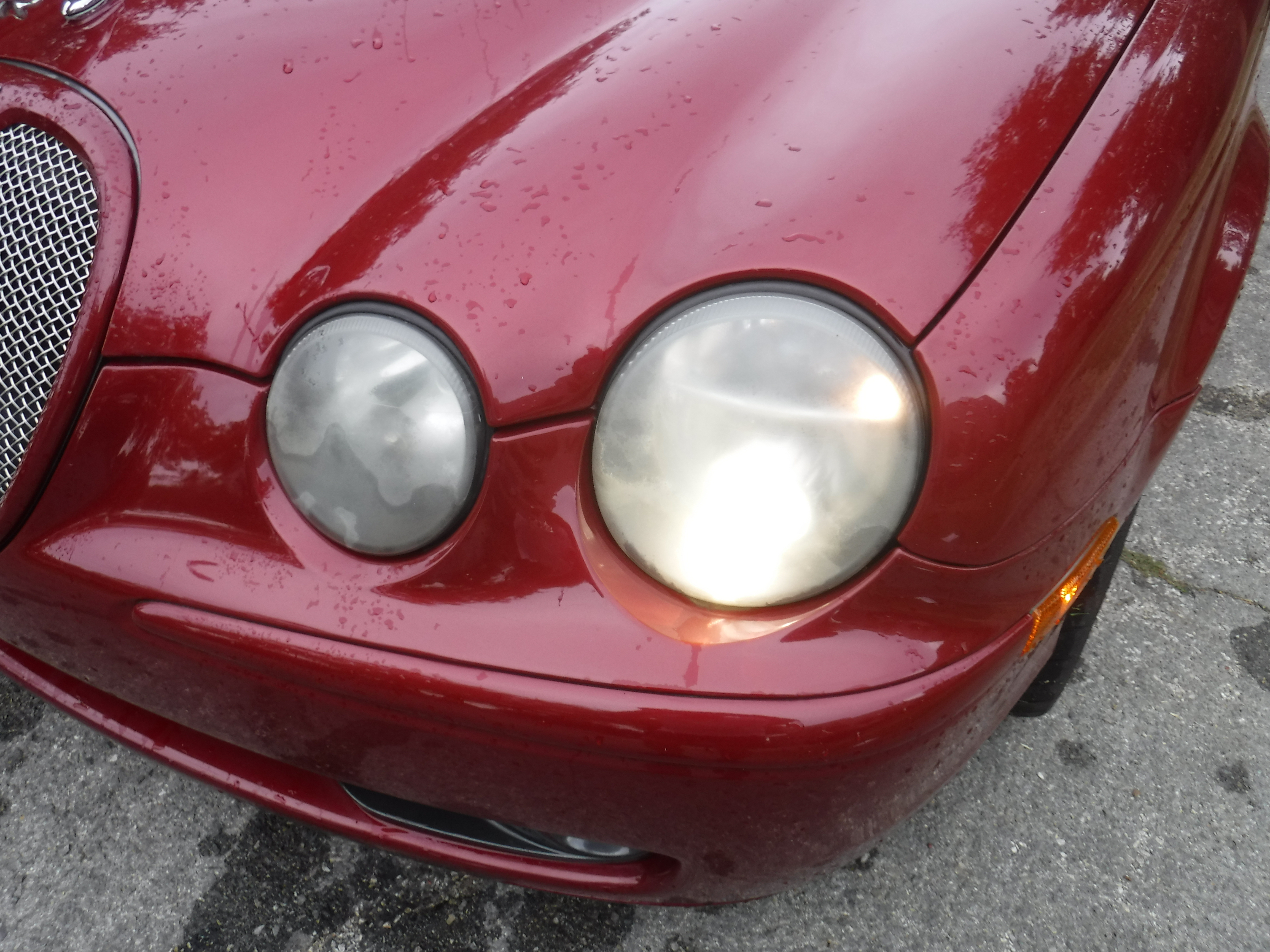

Yes it is. Body appears straight with minimal door dings; some exterior detailing would be very effective. Same story on interior - a few hours spent cleaning would really make it spiffy. I'm thinking $4-5k purchase plus a thou on fluids, spares and cleanup has good project potential. Not looking at this as a flip but to experience for a while. Attached are a couple of pics. I just notice now that it has the (not sure of name) adjustable struts, which I'm sure are very expensive.

Fantastic value for money if any faults are fixed and an unusual colour, especially with the pale leather.
Struts made by Bilstein. Part of CATS.

There are threads here concerning heating a headlight assy in an oven to be able to open so you can repair the sagging self-leveling mechanism. Replacements cost a fortune. Obviously, your headlights can be polished back to clarity.
A replacement demister panel can be found used on Ebay - I purchased one for my older car for around $100. It's held in by a number of clips.

Yes, one of the threads (in X Type section) on headlight adjuster repair is mine. I've also done same repair on my M5. Hella design, with emphasis on Hell, that. I'm sure many of the parts on this car are quite dear; the Damptronic Bilstein struts look to be $400 apiece. The more I think about it, I'm prolly walking away from this one, as seller is asking way too much.
