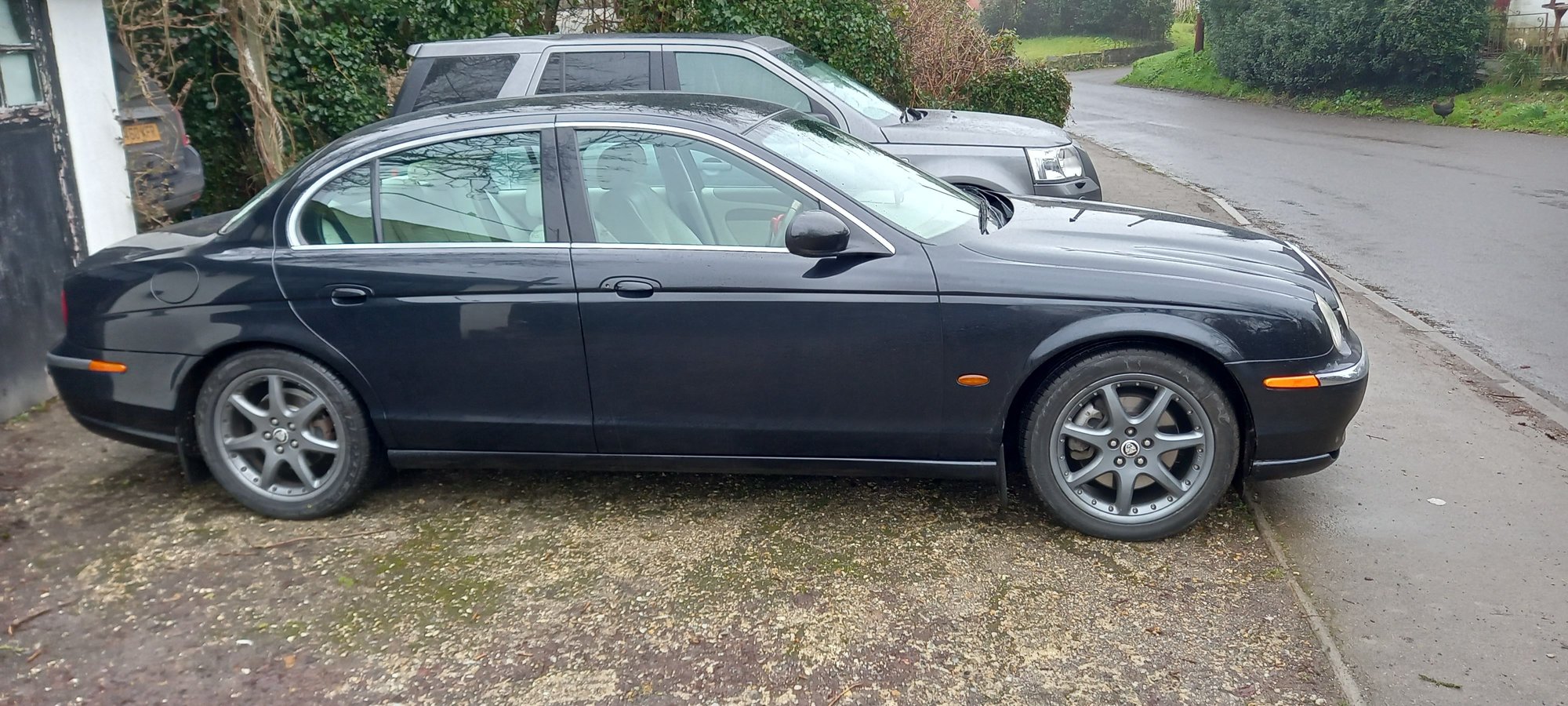

I switched mine from the standard wheels -
Originals
To 18 inch BBS alloys running 245/45 tyres and I think it looks all the better for it.
Handles well but I don't push it through the twisty bits, most of our roads are like outback tracks now.

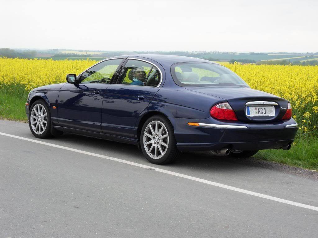

Thanks, NeilR, NewLester and SteveM. I am just looking for a stop-gap until I can get something like the ones on the 1st photo from NeilR. Are those what you call 18" Melbourne? Are they original Jag or another brand? No snow in Geelong, but summer can be harsh. Some of the brands mentioned are not available here, I don't think, at least from the regular dealers. Looks like 18" is the size. What I have right now is standard 16".
photo is from stock web image, repurposed for display only
Old Aug 25, 2022 | 01:57 AM
neilr's Avatar
Joined: Sep 2014
Posts: 606
Likes: 330
From: Germany
Yep the ones on my car are the Jaguar option BBS Melbournes 18x8J ET60 two piece wheels. There is a 7.5J version for the X-type which isn't homologated for the S-Type, so in countries such as Germany, it would make the car unroadworthy! Jaguar (and probably other manufacturers too) select wheels that are anyway pretty narrow for their standard tyre choices, probably to minimize weight, so I would not go lower than 8J wheel rim width if you go with the approved 245/40-18" tyre size. The offset on S-Types is very high. Non-S-type wheels can fit but change the scrub radius significantly, which for me spoils the steering and might even make the car instable under certain conditions where you might otherwise still maintain control. Rule of thumb is +/- 5mm from spec.
I believe the wheels you have are the 16x7.5J Dynamic that were the usual fit on the series 1 SE models. Tyre 225/55-16 95W. Your choices seem a bit different to Europe and some newer models don't appear to be available yet.
Something like this should be fine: https://www.tyreright.com.au/product...16-99W_1019331
$800+ fitted if you buy 4. Is that a good deal in OZ?
