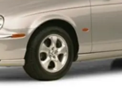

Thanks, NeilR, NewLester and SteveM. I am just looking for a stop-gap until I can get something like the ones on the 1st photo from NeilR. Are those what you call 18" Melbourne? Are they original Jag or another brand? No snow in Geelong, but summer can be harsh. Some of the brands mentioned are not available here, I don't think, at least from the regular dealers. Looks like 18" is the size. What I have right now is standard 16".
photo is from stock web image, repurposed for display only
I have these 16” wheels on mine. I was going to get 18s to improve the handling and style. But then I drove the car for a while and thought, ‘It’s the perfect balance between handling, performance and comfort. Why fix it if it ain’t broke?’
So sometime in the next week or two I too will take the advice here on tyre choice and get a new set of tyres for my original 16” five-spokes. All four wheels are in good nick but all four tyres have perished on the outer sidewalks. Sun damage, in the UK! Who would have thought it?
