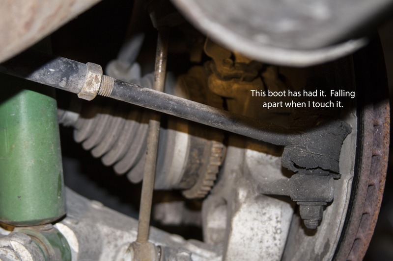

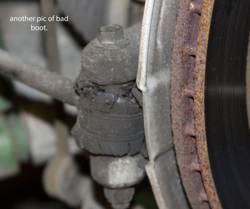

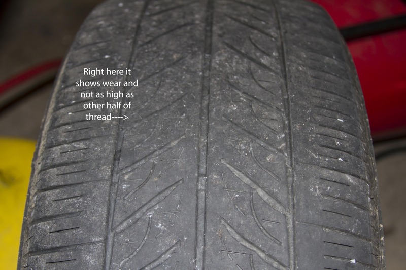

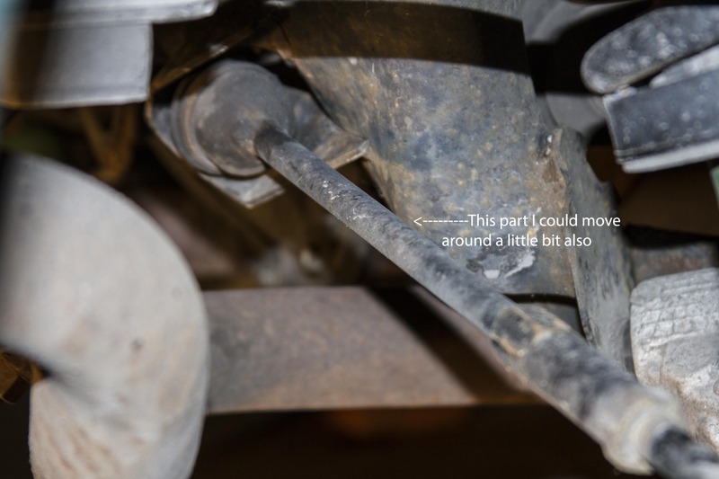

Hello all, Parked the jag in the garage and spent the winter most of the time with my father and used the car sparingly. Plus when you have a jeep, you can drive that and also do a lot of repairs on those which I did. I started to use the Jag about 3 weeks ago and picked up a bunch of salt from the roads. Anyway one of the comments was in reference to the tire making the noise and I think that is the issue.
First warm day yesterday jacked it up and took off the wheel and it is not wearing evenly at all. What is really weird is how it is wearing with some spots on one side of the tire wearing down and on the same side then ok and the other side no wear signs at all. And I was not the best at keeping the pressure correct either. While the tire was off though, I took note to a few things I am going to need to repair. I am posting pics for review. Any thoughts appreciated.

Yes those are your rear tie rods.
The Lincoln LS had some passive rear wheel steering built in as their rear tie rods had some additional "play" in them. But all the aftermarket ones do not have this feature. So you can use the Lincoln part and they are on EBay.
It very common to have those boots go bad. Look at your upper control arms front and back and they are most likely busted also. Along with your front and rear sway bar end link bushings.
I only replace them when they make noise or get loose. If you can feel some looseness then I would plan on changing them.

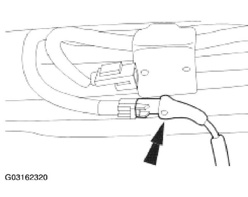

Have On Demand from Mitchell and they are ok but I wish they would go into detail or explain a little better how to actually remove a part instead of just pointing. Here are the three pics they supply with what to look for and where to do it. Anything special here when removing that sensor? Thanks.
