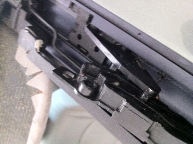

on my str the black window trim on my driver side is pulled away from the door, is there anyway to fix this? also my sunroof in one corner was always low, i tried to reset the sunroof didnt work. so i took it off and on the drivers side the piece that lifts the sunroof in tilt mode a little bit of the tip was broke off letting the slider just roam free, is there a part number for this or a site to buy it from? thanks!

thank you for all the sources i really appreciate it! but i dont know what the plastic piece is so i dont know how to search for it, thanks again!

Try this link for the window trim, it explains how to remove and reattach: https://www.jaguarforums.com/forum/s...ics-faq-29860/
Regent has you covered for the moonroof. BTW there is an adjustment procedure to manually level it after you replace the broken piece.

For what its worth. I just replaced both driver side black trims, and I dont mind parting with the old ones, they are straight and in 8 out of 10 shape. If yours are bent.

How come you changed them out? Did you go to the shiny version?

No sir, we got a nasty hail storm in Dallas, and I was caught in the middle so the insurance deemed they needed to be replaced because the rubber underneath was old brittle.
