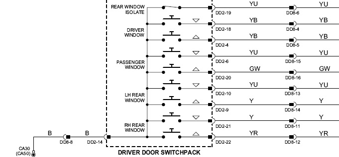

Any ideas? Window fuses are good. From the wiring diagram, it appears that global close goes through the driver's door module, but the driver's window switch-pack appears to be an alternate path. Almost points to two separate, unrelated failures with the same resultant outcome.

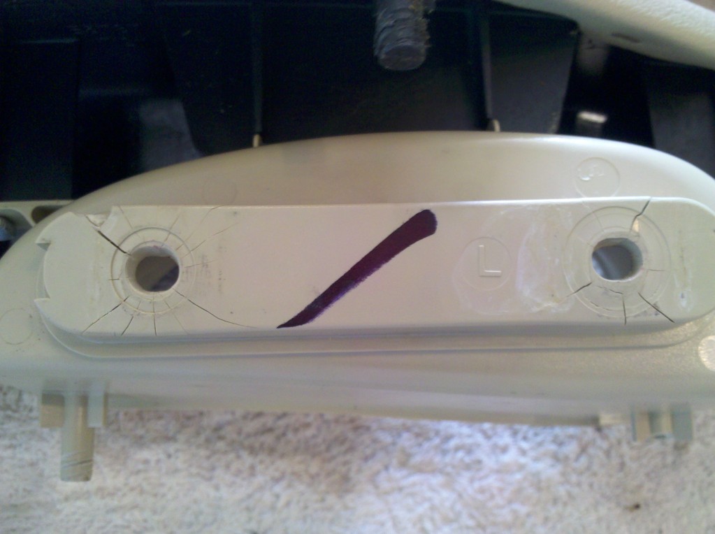

I noticed some stress-cracking where the 2005 driver's door arm rest mounts to the door:
When I was pulling the 2003 apart, a pant-load of beige plastic bits came came rolling out when I was separating the bottom edge. As it happens, it was in worse shape:

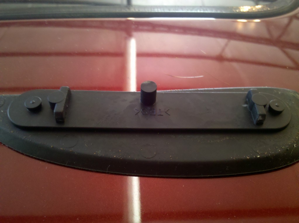

So I set about making some doublers from a bit of aluminum flat stock I had lying about:
Decided to go ahead and make 4 in case I had occasion to pull the pax doors apart one of these days. On second thought, remembered those two screws are the first step and I needen't pull the whole panel to install 'em, so rather than store them to be lost whenever I did have to pull the panels....
In theory, I should've probably trimmed the thickness of the aluminum off the tabs,
but it seems to fit just fine:

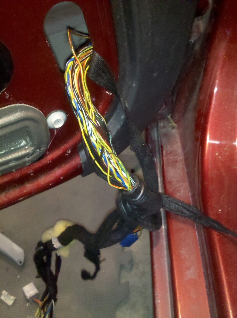

Bob told me to check for +B on the Y/R wire in DT4-2 at the motor. Guess that's inside the door panel -8-pin gray connector so I'll give that a shot next. Had to take a break from it and tend some other matters though
Problem solved "in teary" as my former German colleagues would put it! However, "teary" doesn't wind the windows up... I've got +B on DD8-9 but zilch on DT8-10; Now to unwrap some harness...
Police666 called it, even though I'd rather it have been something else, maybe a bit more expensive part with less labor or something?
Broken Yellow wire with a red stripe right at the point where it enters the cabin bulkhead. I suppose it would've been "possible" to mend it with the door on...but not much room in there to work...I'll try to get some pics up.

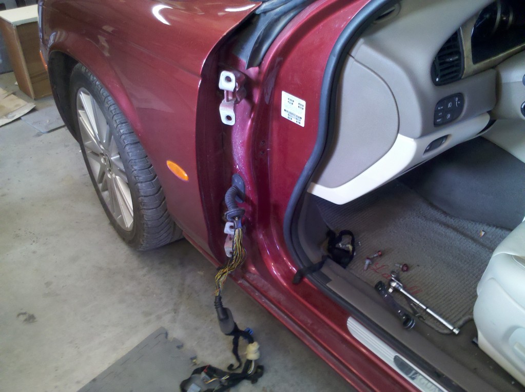

OK, I've got batt voltage on the YR Wire in the blue connector, but not in the gray one (not shown) to the upper left. So I'll start unwrapping at the blue one and follow the YR wire and see where I end up:
Up to here and no break, so I'm going to have to pull the harness out of the door:

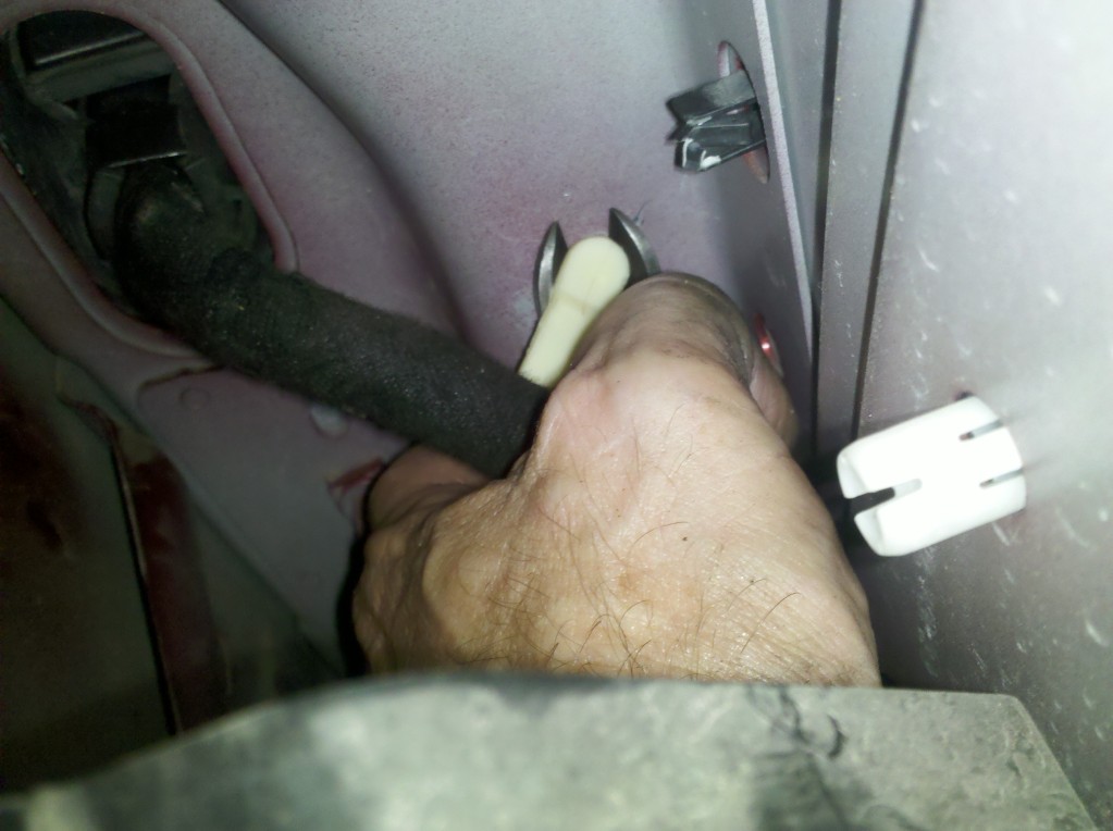

Here's that hanger I mentioned earlier that increases the labor of removing the harness from the door:
I finally managed to get a pair of dykes under it and hoped I could pop it out, but in the very end, I just cut it:
Not too bad to pull it all thru the door after that.

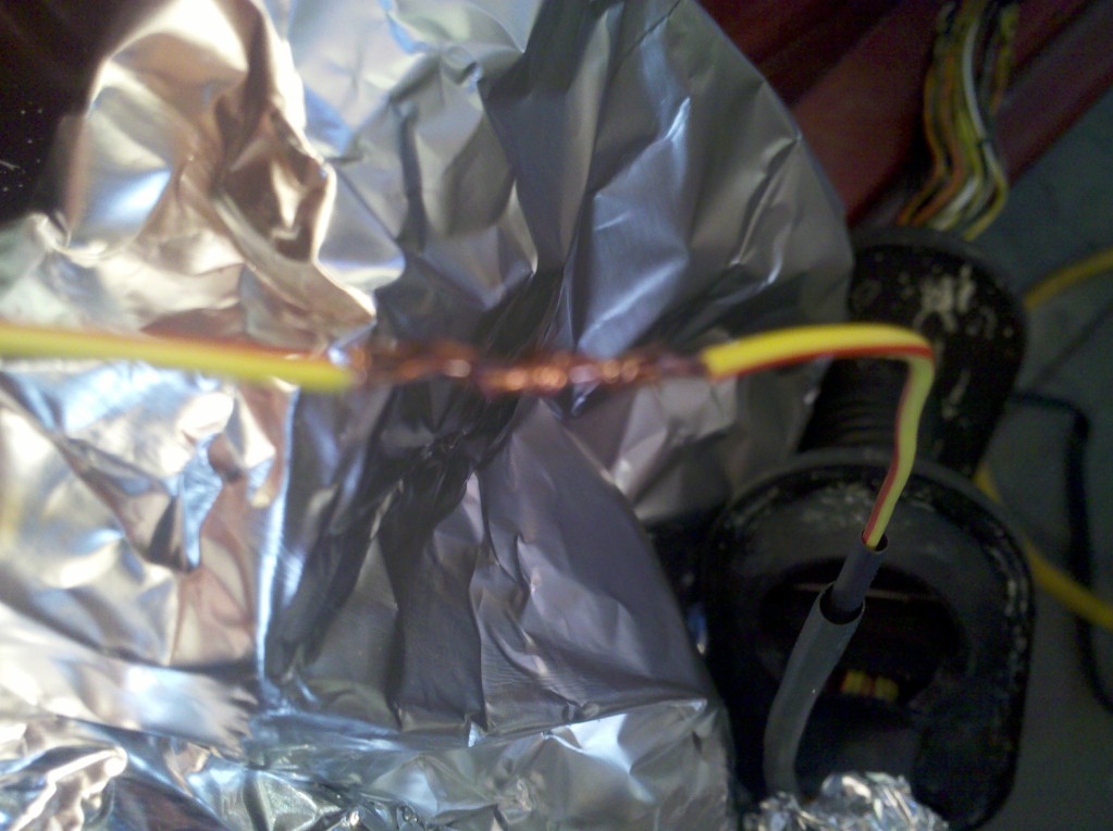

Found one end of the broken wire, but looks like the other end is in a tough spot:
Right then, off with the door:
At last! Both ends:
The rest of the wires were perfect. No chafing, abrasions nor kinks. This one was a clean break, almost looks like someone cut it.
Took a bunch of pics of the solder repair, but the aluminum foil I wrapped the rest of the wires in must've thrown the auto focus off, best of the lot:
Beginning the excruciating re-wrap process:
Ready to reinstall the door:
I tested the solution by dragging the door and inner panel over and hooking it all up - put up the other three windows and cycled the sliding roof. Didn't test the global close on account I didn't want to smash my son's fingers while he was holding the door up!
At last! Both ends:

Still don't understand why the sunroof would open and close without an enable signal using the global function...but just as happy it works now....not to wonder why...
Guess I'll put the door back on today, should have trim panel fasteners Tue or Wed - no point buttoning it up with 4, then breaking who knows how many of them to add the other 4 in when they get here...
Zane that was a great job.
I don't know if the climate had anything to do with it in terms of the wire breaking, but these types of breaks are common on e36/e38/e39/e46 BMW's in the trunk loom that hinges up and down. You start to get random fuses popping, brake and parking lights not working or working intermittently. Its amazing that the break was ONE wire. The BMW ones look like the wires were chewed by rats, not only are some broken, but others have missing chunks of insulation.
The one thing I do with the BMW's is add a small length of wire - yes its double the soldering, but those wires don't have much play - which I suspect after years of use leads to the failure. Almost like taking a paper clip and repeatedly bending it back and forth. After stripping / twisting enough wire to solder, you are making the wire even shorter.
Sucks that you have to pull the door off to fix it.
Oh btw, buy a panel clip puller tool ~ 10 or less. Now that you know where the clips are slide the tool in and pop them one by one. You'll never break one again. They come out straight. its the off axis yank of the door panel coming off with a hard tug that breaks them. And Start at the bottom and work your way up the sides.
Take care,
George
