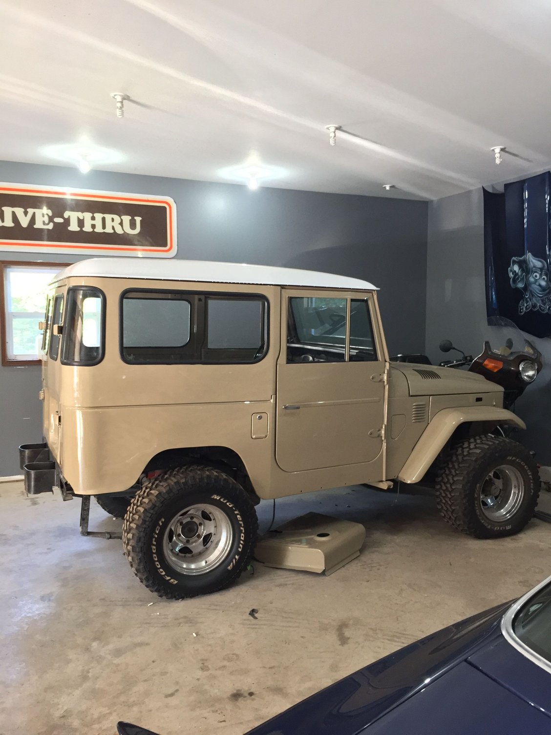

ive mounted a set of seats from a 2007 S-type into my 1974 Toyota LandCruiser and I'm hoping someone could source me the wiring diagram before I start putting power to these seats. There's a lot in them I could potentially F. Up. Thanks!
