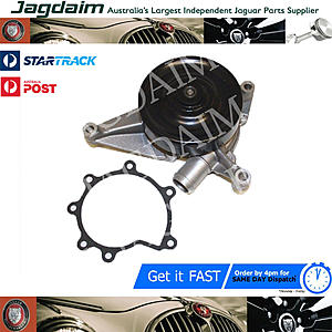

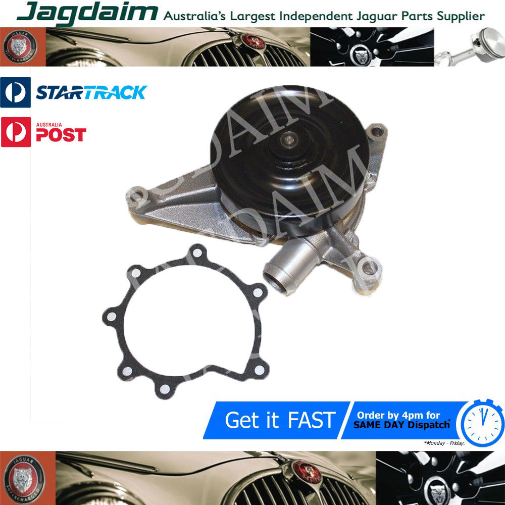

This is the pump I can get locally, and looks like the whole assembly, sooo, why the gasket??, or am I missing something.
