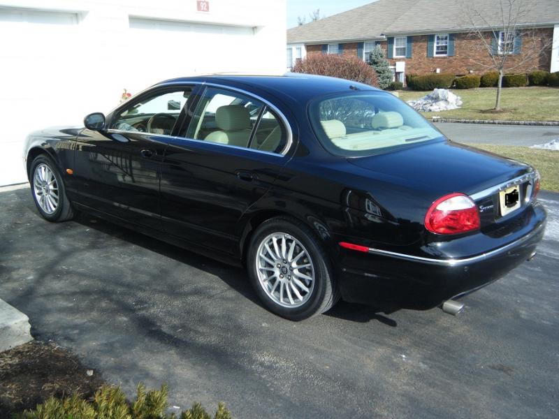

thanks for the reply..i'm not crazy about my current wheels which is why i was considering purchasing a new set.4 New replacement Michelins @ 17" will run me $650 without mount/balancing. This set of wheels AND tires on craigslist would cost me only $500..so as you can see its tempting.. but if it will jeopordize the ride quality, then no good of course..
ive also found a set of 18" wheels/tires off a XJ8. would they workout any better? thanks!
the pic attached are my current wheels.( They are a NIGHTMARE to clean and keep clean)
