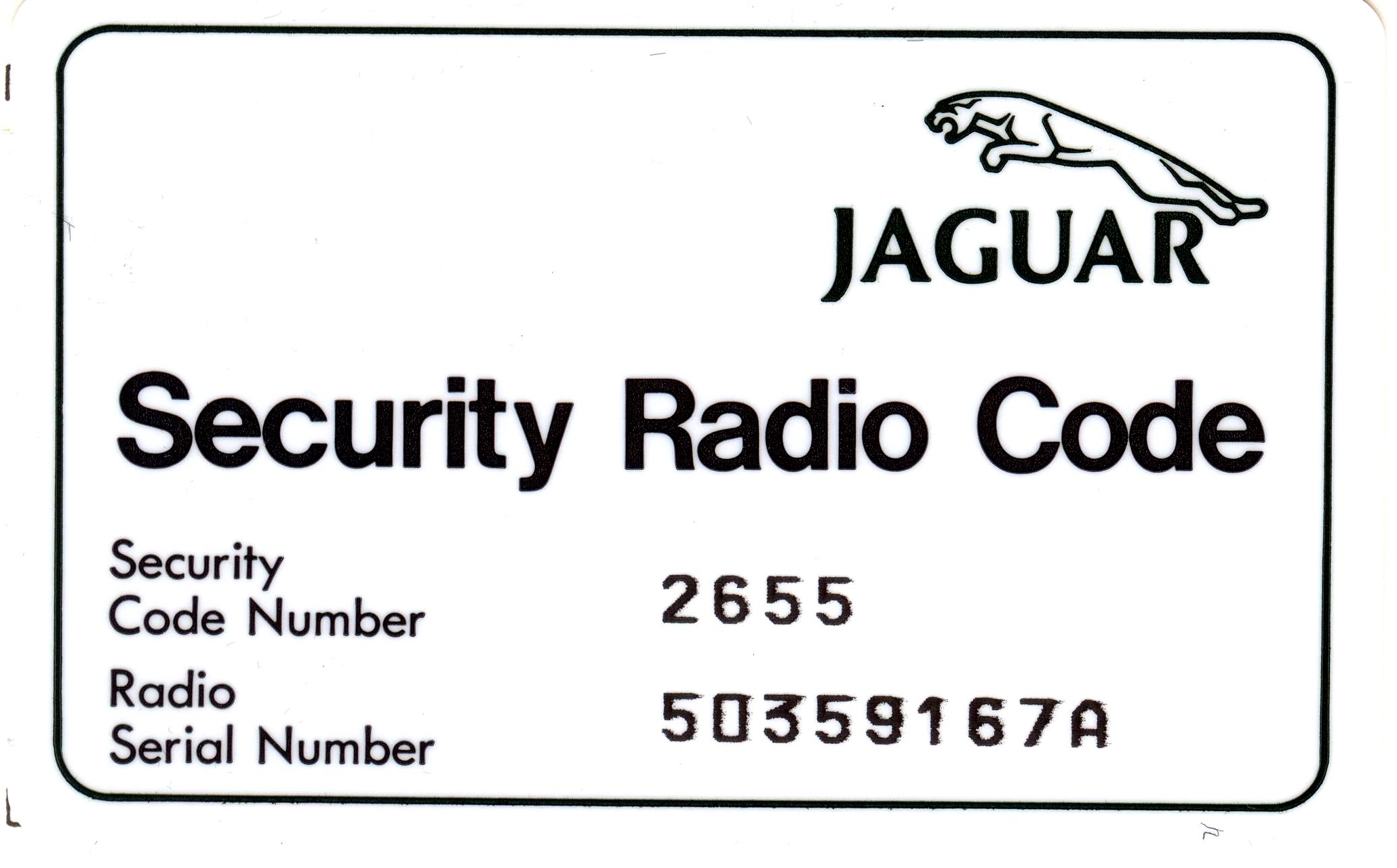

Welcome to the forum Rh63,
Do you have the 4 digit numeric code? It was originally on a card in the Vehicle Document Set. This is an example of mine for my X300 or X308 (can't recall which it was):

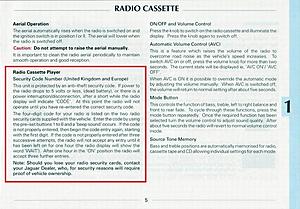

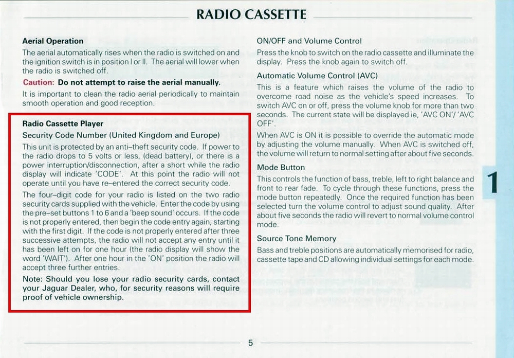

The procedure for entering the code is in the Sound System Handbook:
If you don't have the code, any Jaguar Dealer can look it up for you on the Direct Dealer Warranty System. Proof of ownership such as the V5C will be required and most do not charge.
