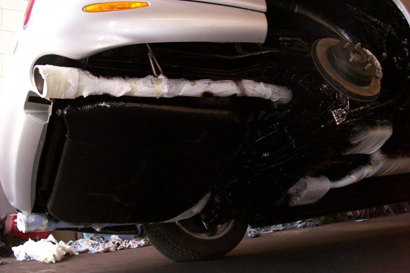

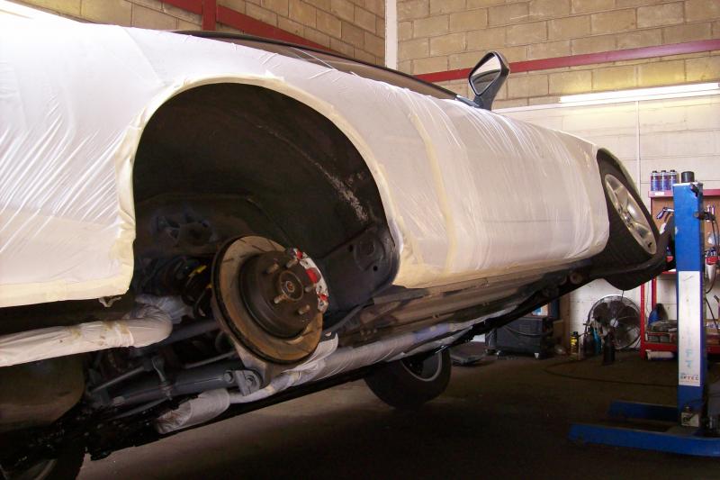

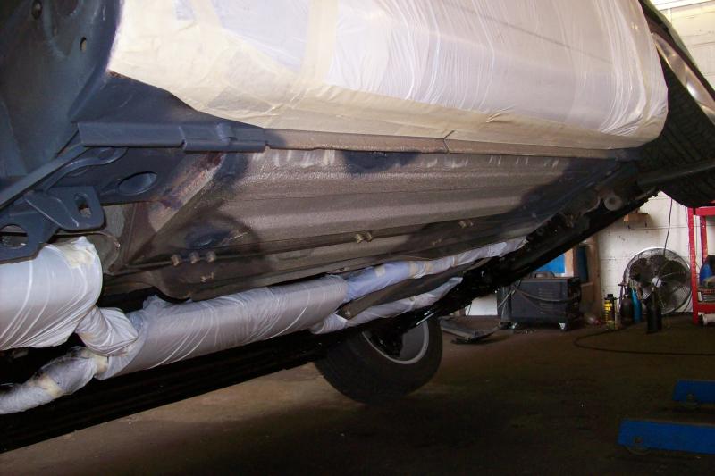

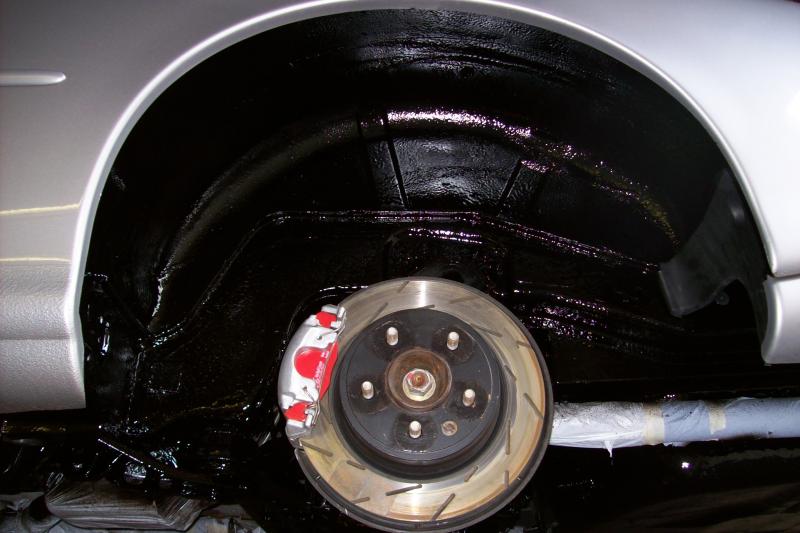

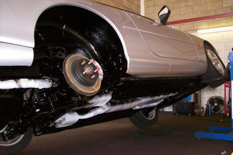

Hi everyone,
Just had my XK8 rust proofed at JR Classics Ltd up at Askern near Doncaster. Brilliant through job, Joe, the guy who did the job explained every thing he was going to do, remove all plastic (wheel arches, front valance etc) completly clean down and remove surface rust, treat with rust inhibitors and then a full underbody coating of Dinintrol, including injecting into sills, chasis members and sub frames and I got a three year guarantee providing I take it back yearly for a check up, well impressed with the result....here's some pics
