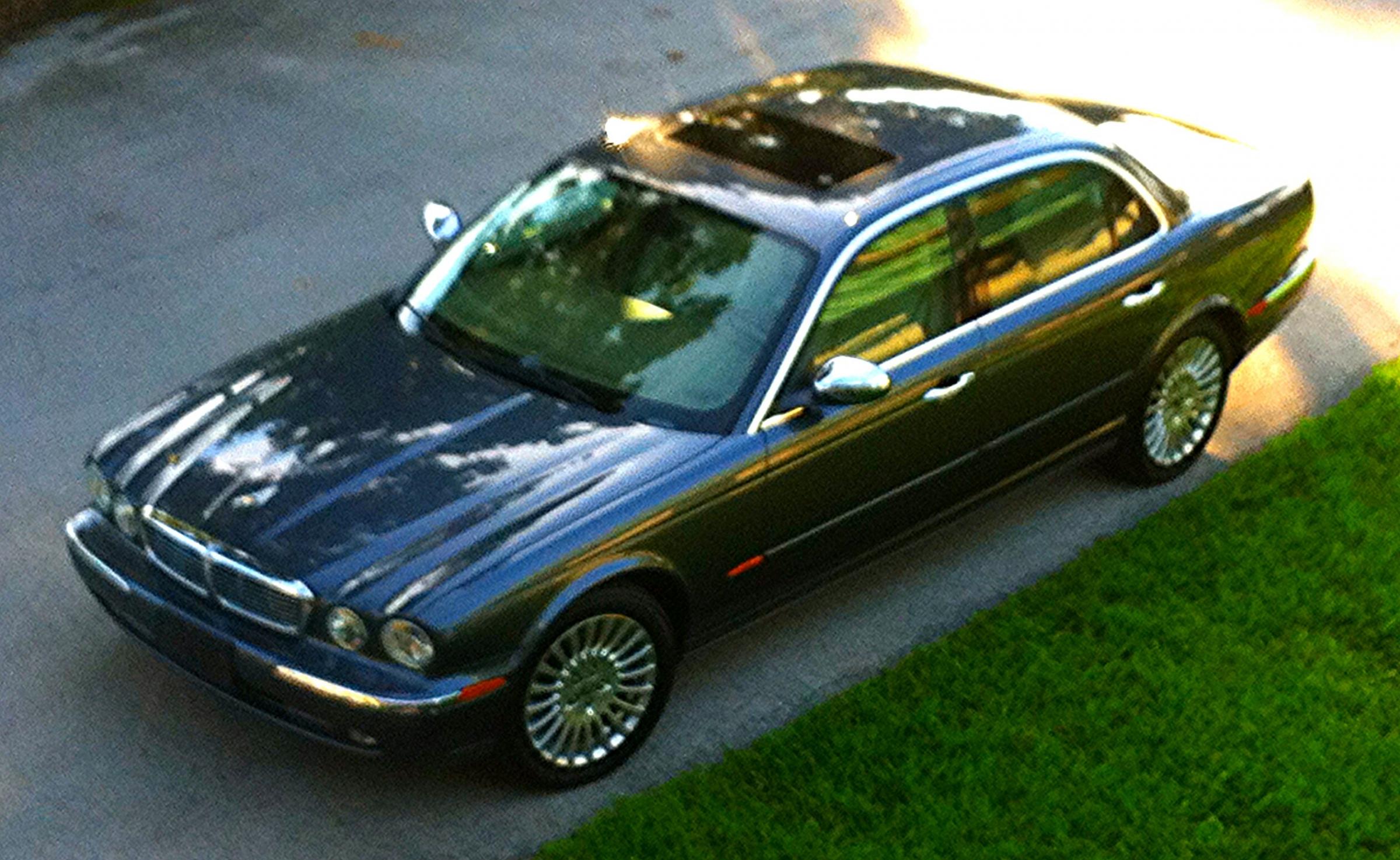

Lower lower south east, key largo,Fl. Just joined. Purchased 2005 XJ8 VDP. Hello and all good stuff. Really happy with car. Drove home from Ft Meyers (3hrs.)with no issues, but getting display one day later of air fault suspension fault. I know this is common, seems to come and go. Handy, sensible, and can turn a wrench. Read about some issues, and will research more. If you have thoughts let me know. Again new and need to post minimums to be qualified to forum. Relay #4?? Thanks, love to drive the car a while without fault display. She's a beauty.
