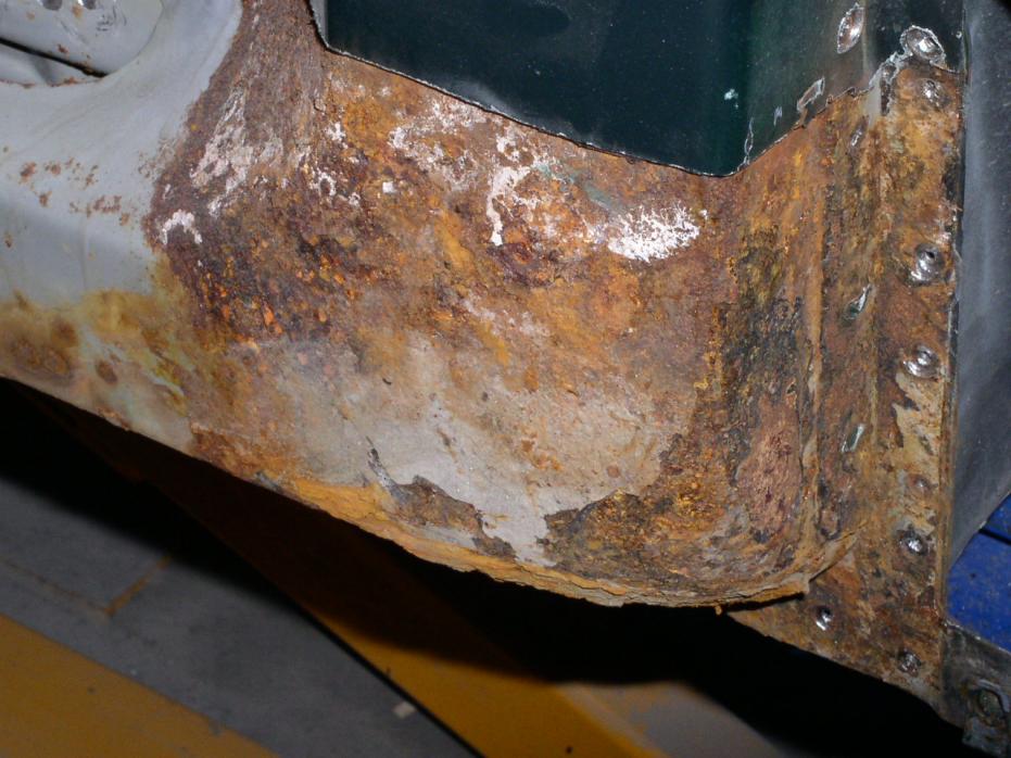

sadly this is what you will see if you go so far as to cut off the outer skin of the rocker panel. It is much worse inside the rocker that what you see outside.....

Wow that really sucks! Good pictures. My wifes car looks fine, which surprises me in this area with all of the road salt.

That looks really bad. I feel sorry for you. I am now worried as I have just bought a 03 X type. I am in the uk, so with all our bad wet weather I am hoping mine does not suffer the same damage. Is amazing what a bit of plastic can hide.....
