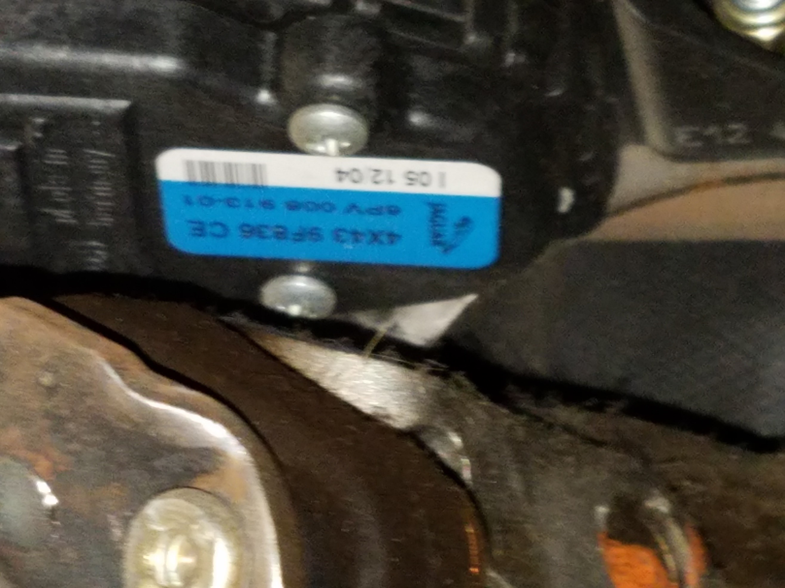

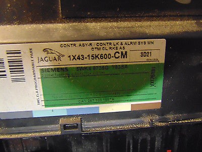

Thank you, this is great information but I must admit I am anovice at this and do apologize. I had searched online and found a picture (pic #1) of the one Ibelieve needs to be replace (although for gen 1x43) and when searching my car, theonly module I could find with the 4x43 was located in the cabin on the drivers side behind the gaspedal (pic #2). Am I looking at the correct module?

Thank you, this is great information but I must admit I am anovice at this and I apologize. I had searched online and found a picture (pic #1)of the one I believe needs to be replace (although gen 1x43) and when searchingmy car, the only module I could find with the 4x43 was located in the cabin onthe driver’s side behind the gas pedal (pic #2). Is this the correct module Iam looking at?
