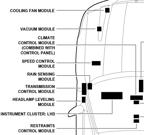

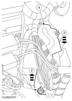

Can anyone tell me the correct location for the Transmission Control Module in a 2006 X-Type 3.0l?
I've been told that it is above the brake pedal, on the underside of the firewall, also behind the glove box, on the underside of the firewall, and also on the driver's side "kick-panel, behind the Hood Release Lever, and also under the hood, on the firewall. on the passenger side.
I'd rather not disassemble the entire car, just to locate this part!!!

Hope this pics help
Attached Thumbnails '06 X-Type TCM location-x-tcm2.jpg   '06 X-Type TCM location-x-tcm.jpg
