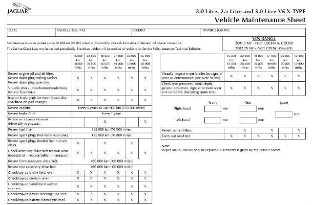

Hey guys my 05 X-Type 3.0 is just shy of 20,000 miles. What is recommended at the 20,000 mile mark?

Hey Buck...that rocks! Thanks for posting that.
