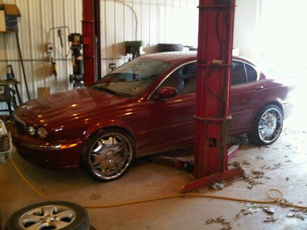

Hey, I have a 2002 xtype, I just put a pair of aftermarket 20 inch rims on it (235\30\20), the front drivers side tire is hitting inside the wheel well and it buckled the fender. My mechanic used a rubber mallet and bent it back and further up into the wheel well but it still does it, if I slow right down over any kind of bigger bump or pot hole it doesn't happen, but it can be very frustrating. The passenger front side doesn't do the same thing but slightly rubs the plastic protecter in the wheel well but no damage. Oh FYI, the driver side where's it's happening does not have that plastic protecter in the wheel well. I am at the point of taking them off and putting the factory ones back on but really don't want too cuz they look boss! Here are a few pics, any information, suggestions etc would help guys! Thanks,

Whats the offset and width of your wheels? You might need to roll your fenders or run a 225 or 215 instead of the 235s.

The recommended max rim size is 19" with a 225/35-19 tire. Any larger sizes require suspension or body modifications.

when you go bigger you go out also. you needed to get a different offset to make up for the changes in width. like right now if your at -48 you need to be at like -35 at least maybe even more.
i always added spacer blocks to the springs when i had 20"s on my cars especialy these small ones. it lifts the car just a tad (depending on size of course) and keeps it from sway cutting the side walls. the edge of wheel well up at like a 20degree angle insted of 45 degree and it wont cut tire.

Probably will have to roll your fenders... Be careful about cracking paint. The wheels look nice but you will probably have to go with the lowest profile tire you can get.

Ya brother your tires are just plainly too wide, need to back them off to 225s at least and make sure your offset is above 40 to make them tuck more
