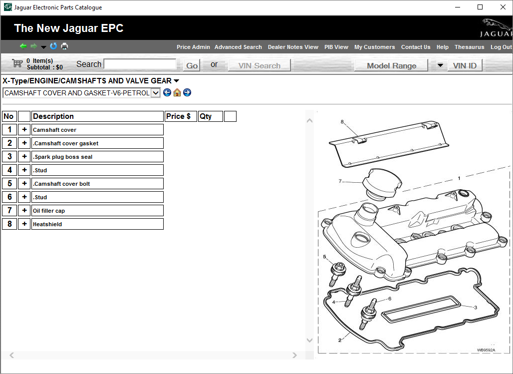

ok middle rear coil was fried. Took a bit to get out. That must have been the smoke. Looks like it was touching the underside of the manifold.Still concerned about the oil in the holes. Does that mean I have to replace a seal?

Do it while it's apart, yes.
Cam cover gaskets, better know as valve cover gaskets
Yes - #2 & #3 in the screen shot - #3 seals the spark plug wells. I'd do both sides while in there. By the way, how do the plugs look?
Attached Thumbnails 2003 Jaguar X Type 3.0 Engine/no cruize available-tmp.png

Yeah I figured that thanks.I ordered the seals for both sides. The plugs had the normal wear no fluids on the spark portions just on the outside due to the seal leak.Going to change all of them after I get the seals fixed.
