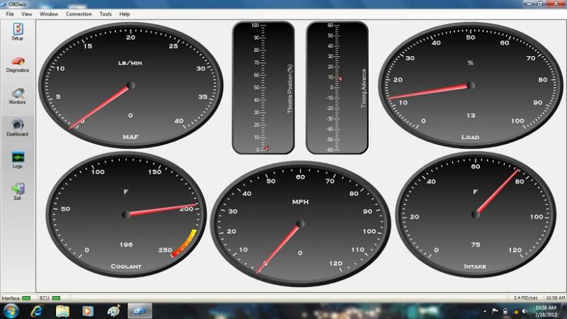

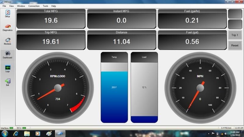

Old Feb 19, 2012 | 08:50 AM
Chrys's Avatar
Posts: 26
From: Boston,MA
Exclamation P0171 & P0174 scan tool results photos
Thank you Norri, photos are attached.
Thank you Gus as well for your information.. Maybe now you can read these test results and point where the error codes are ...
Thank you again guys!!
Attached Thumbnails 2003 X-type Fault Code: P0171 and P0174-jag1.jpg   2003 X-type Fault Code: P0171 and P0174-jag4.jpg   2003 X-type Fault Code: P0171 and P0174-jag7.jpg   2003 X-type Fault Code: P0171 and P0174-jag9.jpg   2003 X-type Fault Code: P0171 and P0174-jag10.jpg
