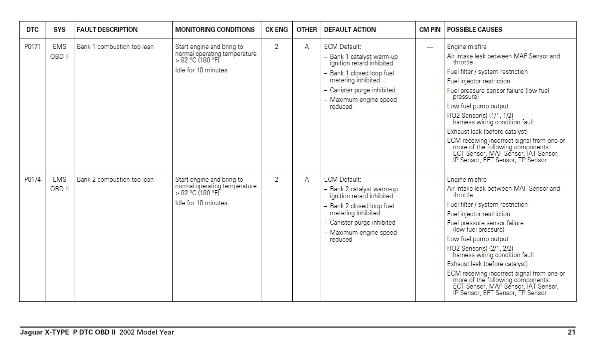

Here is the extract from the Jaguar DTC List for P0171 and P0174. See the right hand column for 'Possible Causes':
You will see under 'Default Actions' that maximum engine speed is reduced when these fault codes are logged which explains the loss of power.
P2098 does not appear in the Jaguar list.
The random occurrence of the issue and improvement in colder temperatures points to a sensor problem more than a fueling issue.
Troubleshooting this is going to require some sophisticated testing and, as others have suggested, a professional diagnostic could be the lower cost option.
