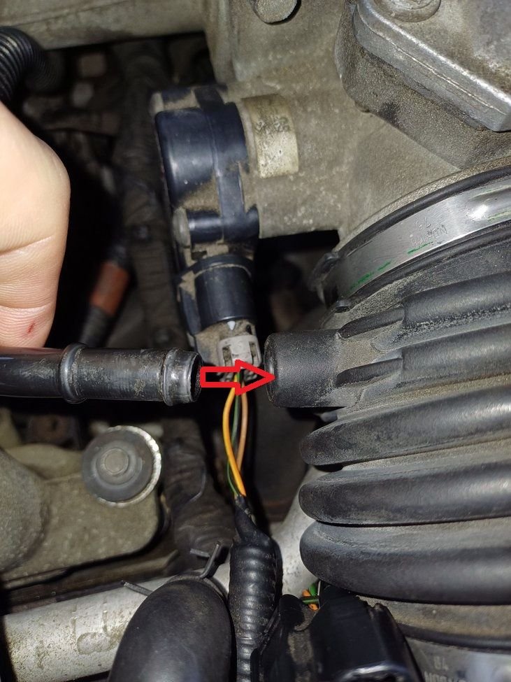

In the meanwhile: does someone know what this disconnected tube is?
Old Jan 19, 2025 | 02:38 PM
JagV8's Avatar
Posts: 27,556
Likes: 4,929
From: Yorkshire, England
No, but if it's involved in engine vacuum it's likely your problem.
Someone will know...

I don't think it is necessary to check on my X-Type in front of the door, as I have removed the air-intake that many times, that I am fairly sure that THIS goes THERE:
And yes: It is a vacuum hose and it would cause problems, if not connected...

Hose clamp not so sure, dont see it on other x-type engines.
However, you are right where it should be connected.
Weird thing is, i found out i drove thousands of miles with that hose disconnected without any problems.
No check engine light either.
How could that be .
How could that be .
If enough OBD monitors are unset, then more and more codes can't flag (it doesn't know what to trust) and will probably run OL (open loop).
If it does, to protect the engine from catastrophe (lean!) it runs rich. So, worse MPG but also more burning fuel in the cats
It's bad for the cats - but lean would be worse.
