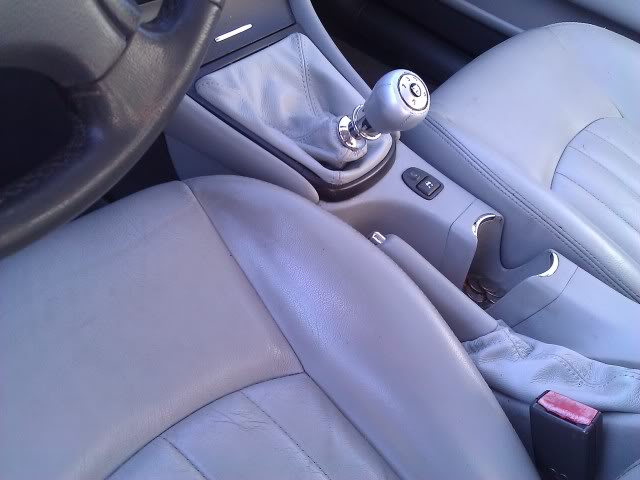

If you look in the space between the cupholders and the shifter, is there a button to deactivate DSC or are there three coin slots?
If there are three coin slots then you don't have DSC. If you bought a 2004+ with no DSC, then the symptom you described is normal for the car. A 2004+ without DSC only has fully functional AWD on dry pavement. Once wheels start slipping all bets are off.

We were looking at the manual and it mentioned DSC, but we couldn't find the button. Did see 'sport mode' button.
Car isn't here now. Will check and repost.

No button = no dsc!
