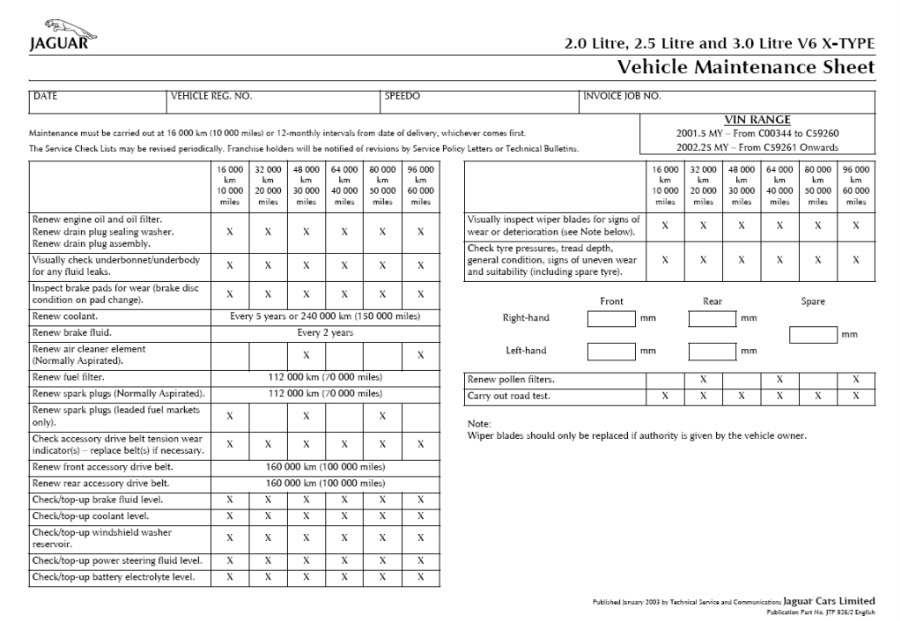

jaggirl, for 10K mile service, I would say to definitely get the oil changed. After that, based on where you live, having the air filter changed would be a good idea too. After that, you are mainly looking at inspections which most of them you can do yourself or have a friend/hubby do for you. You should have all the fluids looked at to make sure that they are up at their proper levels. IF you pay someone to change the oil for you, they should do this for you. After that, you should have the brake pads looked at to ensure they are not wearing excessively, the tires rotated, and then possibly new wiper blades. But, beyond that, not much you really need to look at with that few miles on the car. You should be able to have a shop rotate the tires and do a brake inspection for you for around $50.

Jaggirltoo.....I see you learned how to use the forum and post....go you
You're in great hands with Thermo, but I've attached a copy of the service sheet below
