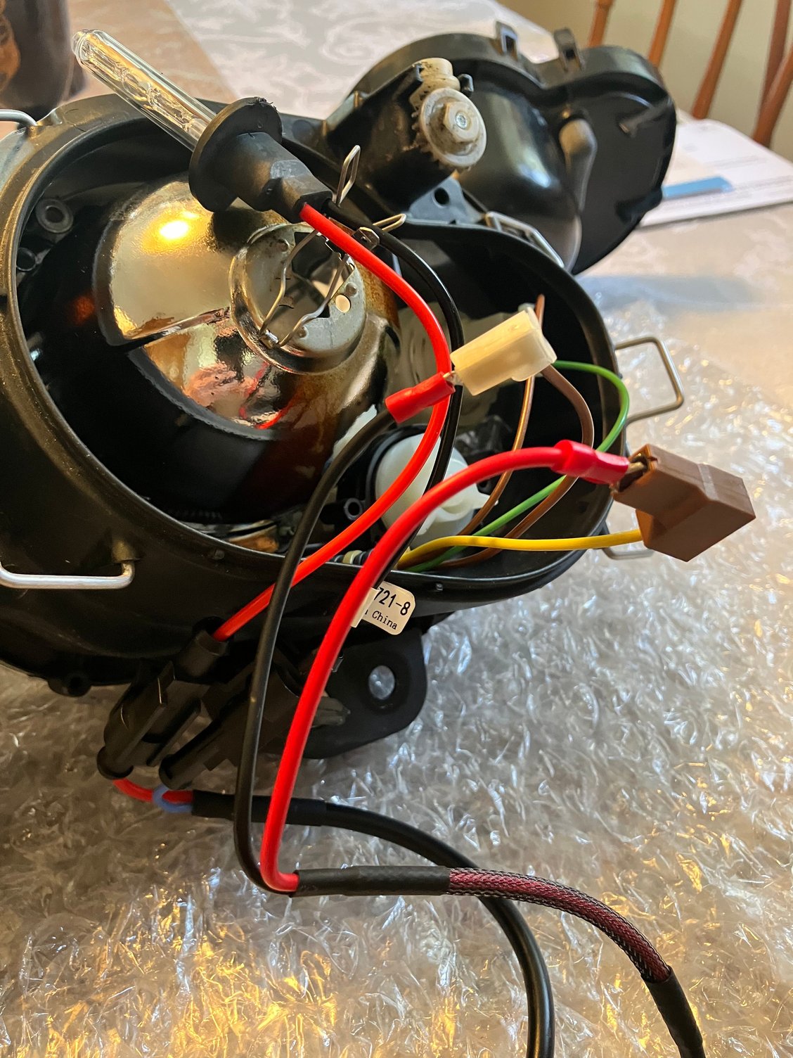

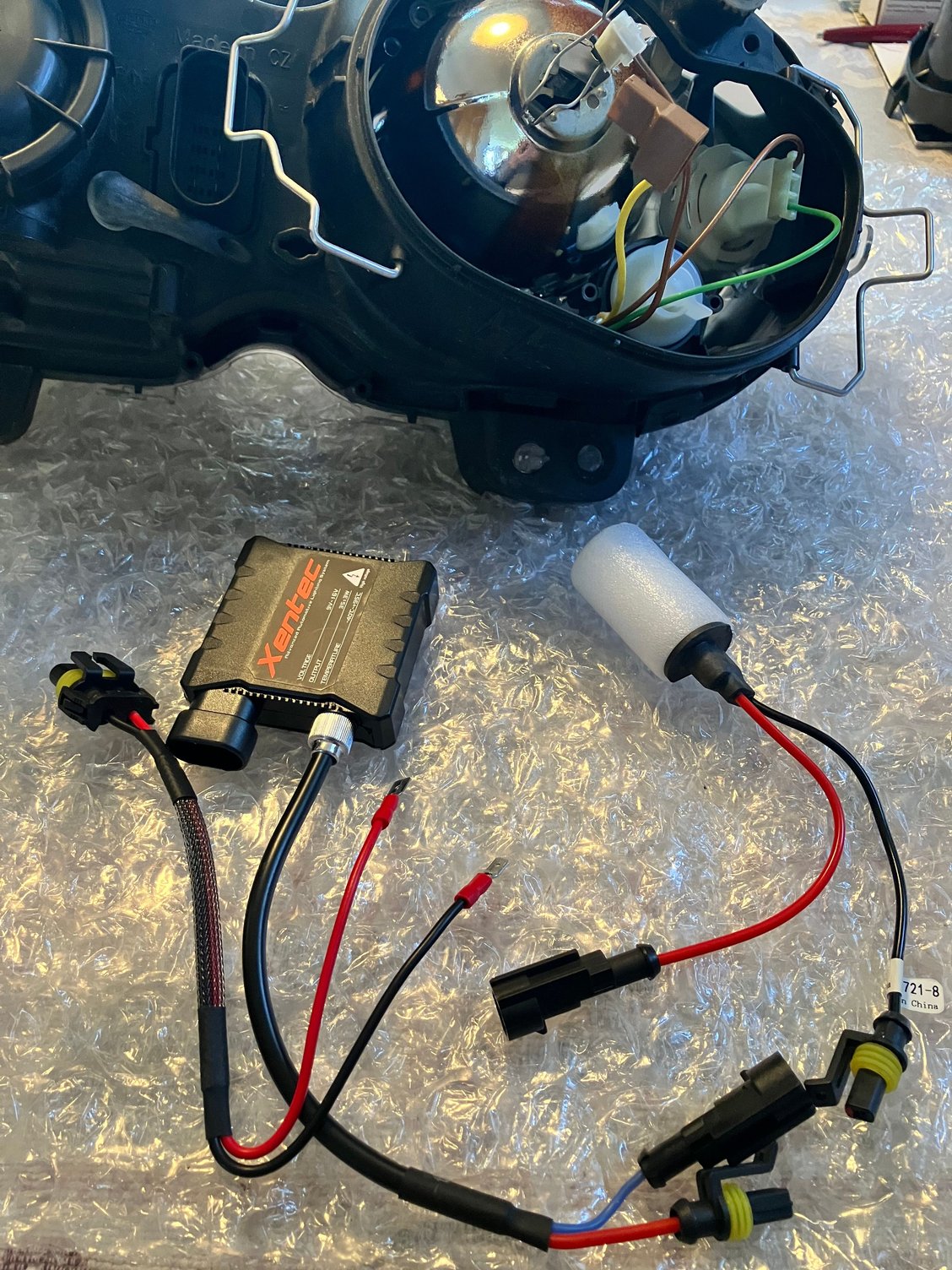

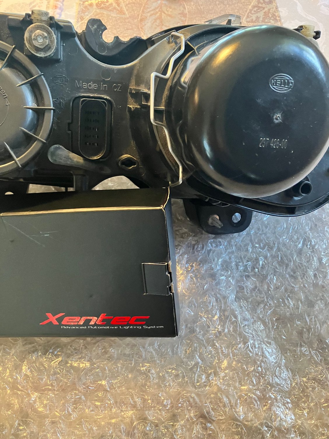

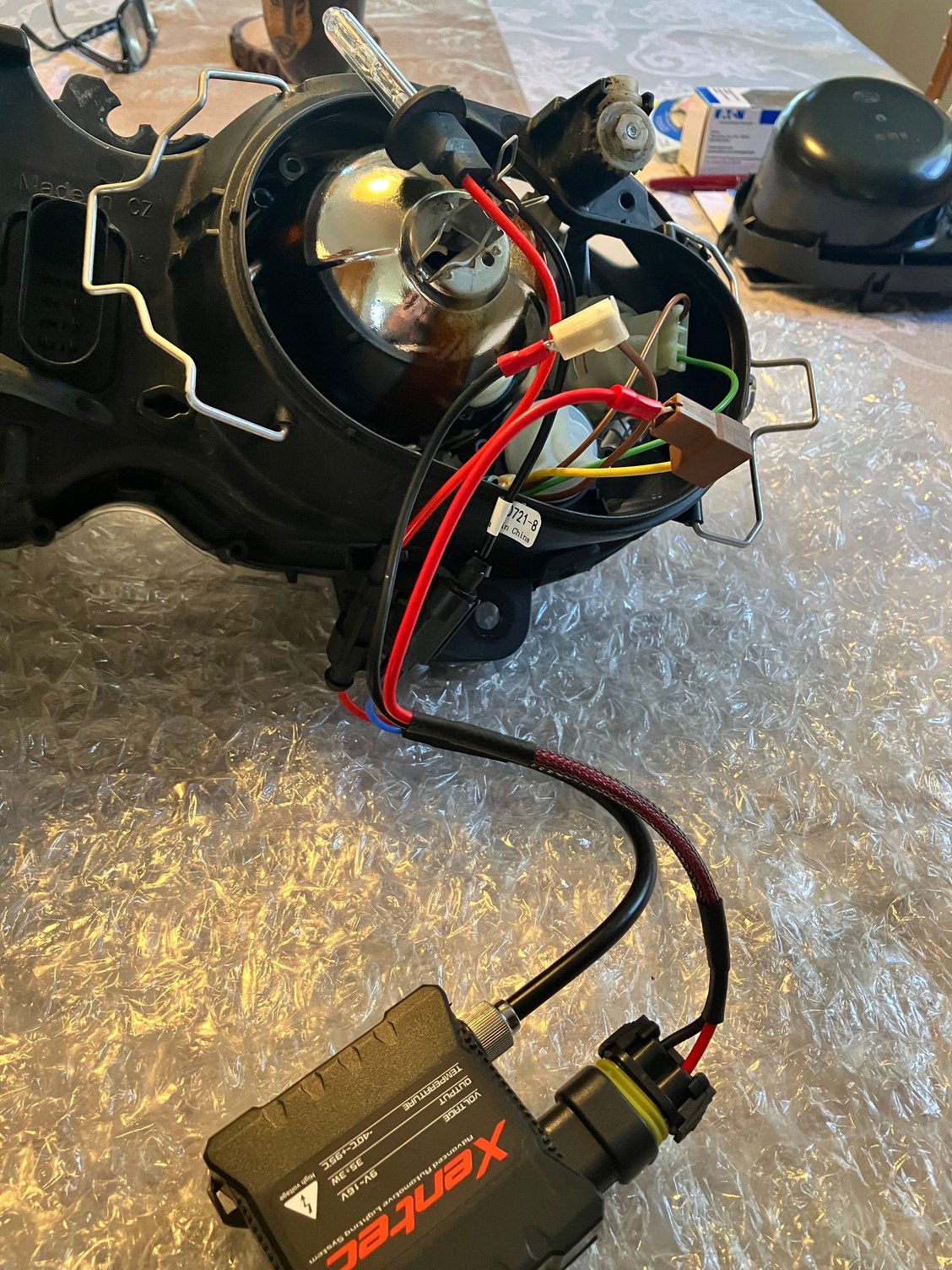

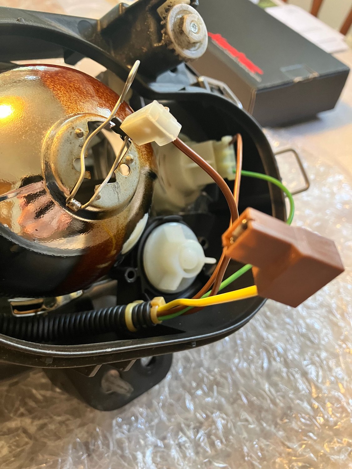

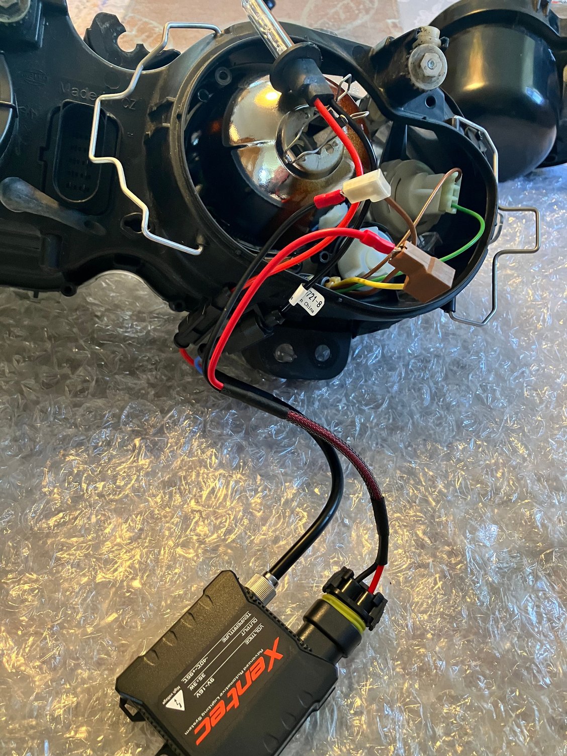

This is the kit I got. I just put it together on a spare headlight housing I had in the garage. The wires seem pretty good to me. It’s all plug and play. Like I said I think it’s a 35 watt kit. Lemme know what u guys think. I don’t wanna ruin my cat by using it if it’s not safe to install. Thx for any info.

NYCJAG2006, Xentec is what I went with and had good luck. Now, I will admit, my kits had 1 difference that I do not see with yours. That was the wiring had a rubber grommet that allowed the wires to go through the back of the headlight cover and the grommet formed a seal to keep things water tight. This does a few things for you. 1) less things in the headlight housing so less likely to have something break, 2) the ballast can be mounted in a position to get it away from heat which will help it last longer, and 3) allows you to ground the ballast to the frame of the car vice having to rely on the factory wiring (this helps with the lights being able to start).
One other note, when putting in the HID bulb, make sure that thing is sparkling clean. Any sort of finger/skin oil on the bulb will shorten its life. Dirt, same.
