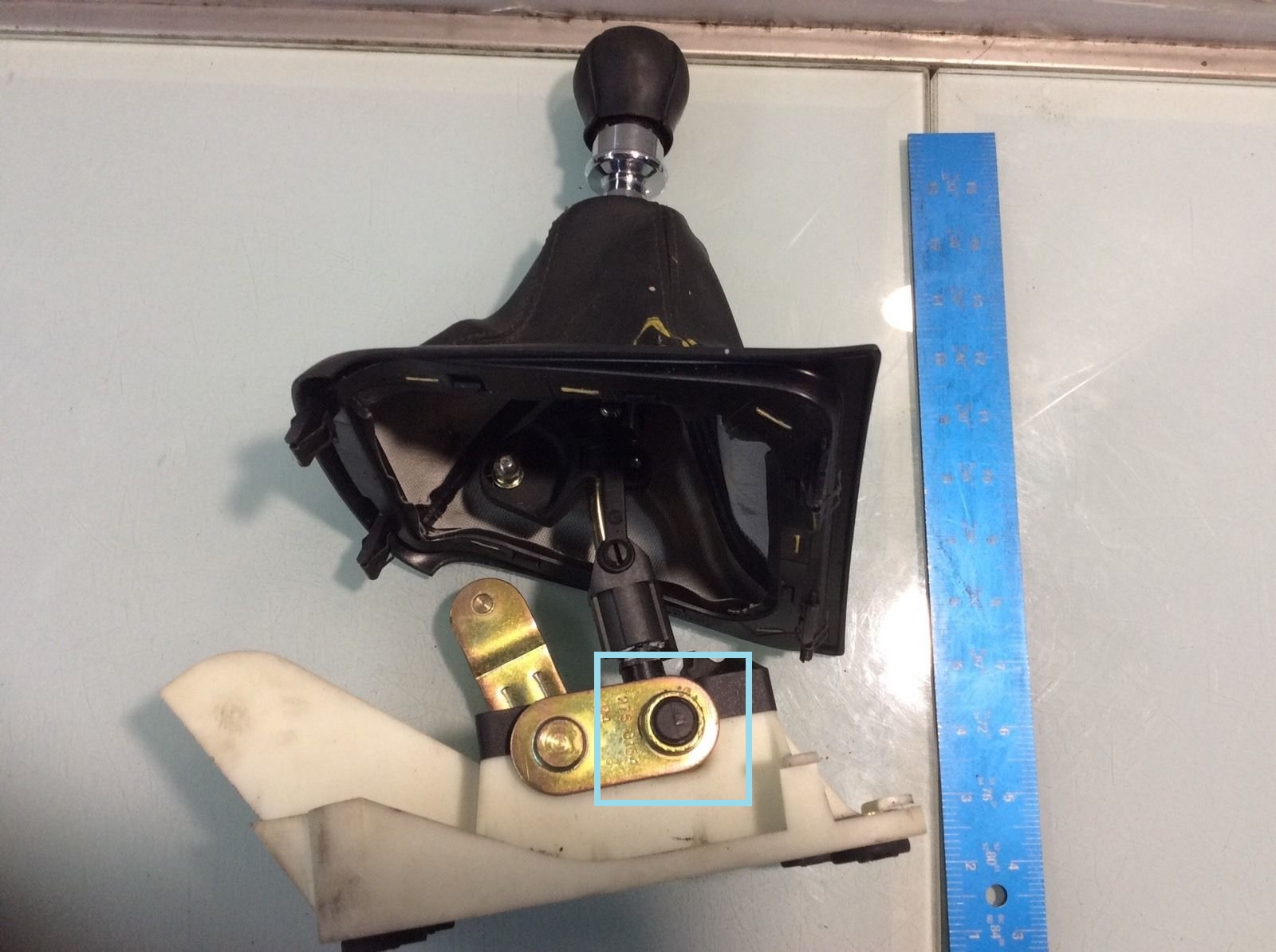

New to the forum, new to the Jaguar. I bought a 2002 Jaguar X-Type 5-speed Manual recently and the only issue with it is that the shifter is loose horizontally. I opened the console and pulled the leather shift boot up and I can see a pin that is wiggling around and seems to be missing a bushing. I looked up a shifter assembly to compare it with mine and I think I am right. I tried the search tool and it doesn't really show me any information.
Is there a bushing that goes into this? Or do I buy a whole new shifter? In the attached picture it shows the black bushing but mine is completely gone. Is there a part number to this? I can't find any listing online and my dealer is 4 hours away, I called them and they apparently don't have a clue what I am talking about.

Is the bushing in question marked by the blue box outline? I can contribute nothing to your knowledge here since my manual shift does not seem to have the looseness that you describe and I have never heard this complaint before.
It is hard to understand how a bushing could go missing entirely - even if it broke into pieces there would be some evidence of it below, no?
I doubt that you'll find the piece as a separate listing but could you not adapt a bushing to fit?

Yeah I put an outline around it. Being that it is black, I assume it is a polyurethane or rubber bushing. I am not sure if maybe my design was welded as there is not particles or pieces around. I am going to try to snap more photos. Being that this car is 15 years old I am sure this problem may occur with other Jag owners. Maybe this information can be of value.
I went down to a European car specialist to see if he had any ideas and he didn't. I might bite the bullet and buy another shifter entirely if I cannot find a solution.

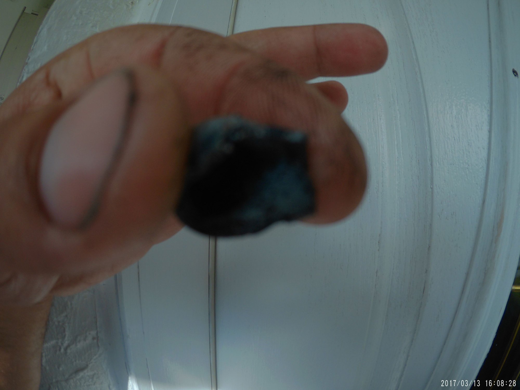

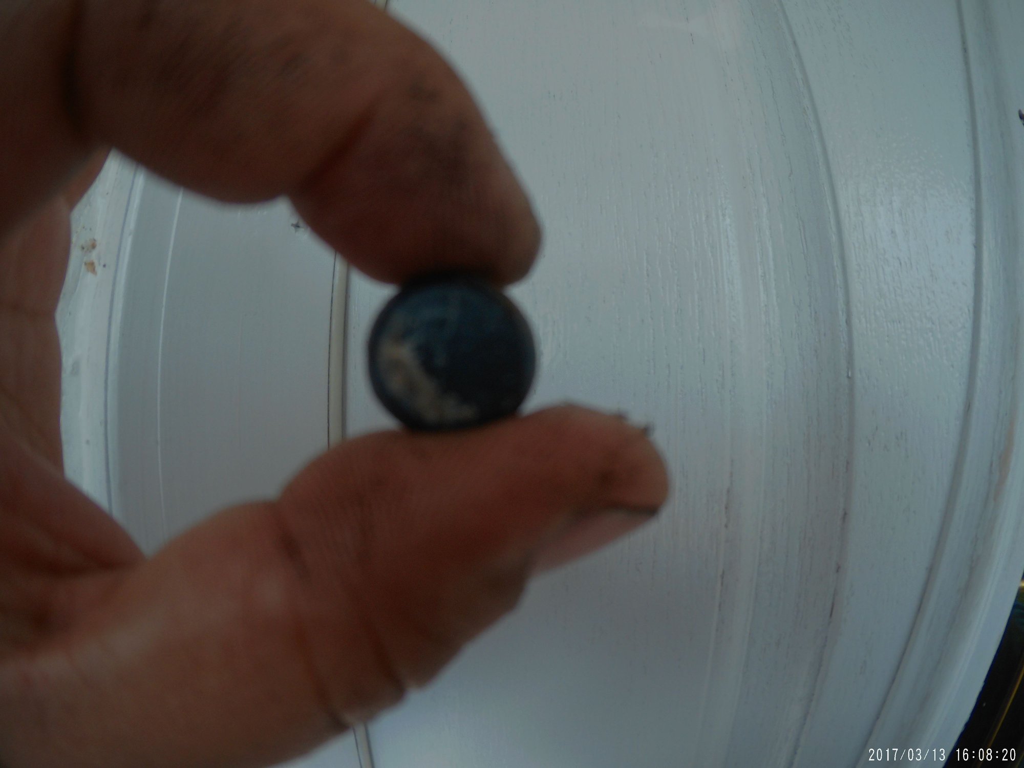

Ok I found the culprit. Yes there was a piece left but it was pinched between the foam that insulates the console.
The bushing is pushed into the "bowl" and locks in while holding the alignment pin in place. So i guess it is off to the parts store I go to find a solution.

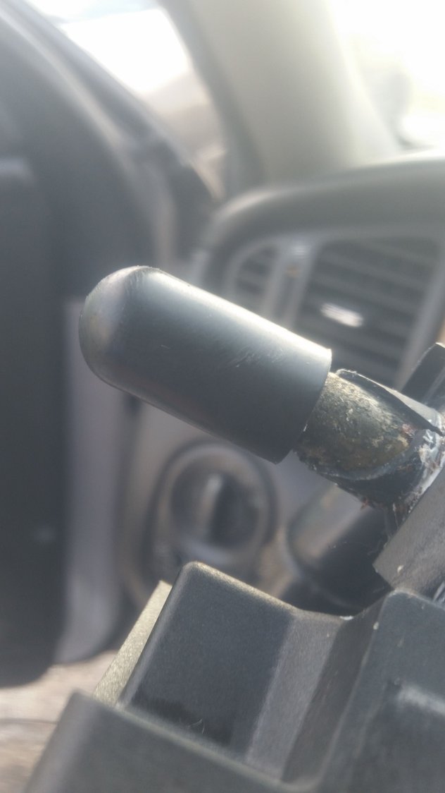

I bought Vacuum caps from the auto part store (Advance Auto) Part #: 47395. It is a 3 piece set for $3 USD. I removed the shifter cables from the shifter. I then removed the shifter stay that has 4 phillips head screws and lifted gently to pull the shifter and pin out together.
Vacuum cap on horizontal shifter pin.
After you are done you should be left with this. A bushing and a better feeling shifter to allow you to have time to order the correct part from Jaguar if they know what you are talking about.
