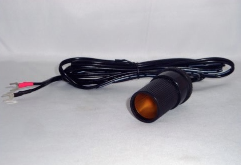

So I added Sirius Radio to my X Type. The head unit was pretty small so I decided to use the ashtray. The radio used a plug-in for the cigar lighter to get it's power so I bought a 'female cigar lighter adapter' and took the power from the Jag's cigar lighter. The hole under the radio is huge so it went neatly outta sight!
