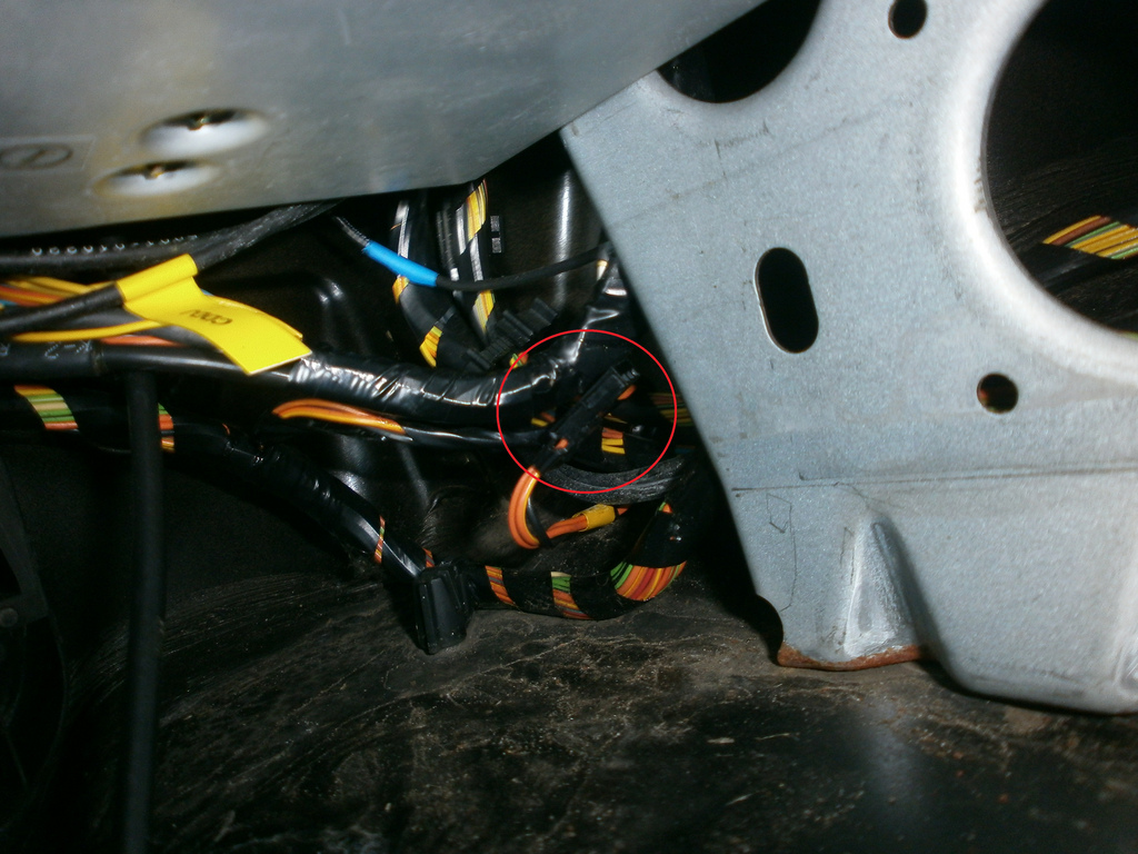

My X-type does only have the casette player.
There isn't a cd changer in the boot/trunk where it should be.
Probably they put my cd player in another car on the lot
Anyway, what do i need to play cd's again?
-CD changer
-Harness?
I had a look in the boot to see what's there, and i found some loose connectors.
Is this where the cd changer goes, where are the loose connectors for?
Also, if i buy the voice controle module, will it be plug and play or not?
Please see the attached pics.
Thanks again

Hi there, My X-type is a stock basic model with the cloth/velour seats, no air con and just has a tape player.. the person before me (thankfully) brought a Kenwood 6 CD changer, mounted it under the top of the boot and plumbed it in via an aerial adapter and a small header display fitted where the ashtray and cigarette lighter used to be. It is accessible when the ashtray cover is raised and is on a radio frequency.. my point is that he went to this much cost and trouble because he couldn't just plumb in a CD changer easily.. your pictures do show cables similar to what I had in my previous XJ but I wouldnt want to guarantee that by connecting up you will have CD available to.. *and* I dont know if it still the case but in my XJ it used an Alpine CD changer with a different pinout to the usual which meant a stock Alpine would not work!
Others on here will likely know more than me about this but my advice would be to be cautious and not expect it to just work :-(

Loads of info for CD multi changers on the UK jag forum, I put one in the back of my estate soon after buying it. The power lead is already there which you have circled in your second picture. The unit is controlled via fibre optic cables which also control your sat nav. You will have to buy a further fibre optic lead and join it into your sat nav circuit. Here's a link to a fibre optic guide which should explain more http://www.mjtemple.webspace.virginm...tic-cables.pdf

the harness you circled is for accessories,here in the us we use for the satellite radio receiver or rental companies would used it for accessories its constant switched ignition and ground with a female connector in place so you can just add terminals
The one you need is usually tied up and is very small possibly 2cm x 1cm with 2 wires going to it possibly the 2nd pic hard to see
you will also need a d2b harness for the changer
the voice uses a white connector the i do not see,not all vehicles came pre wired for voice connectivity if you have a phone (you do i see it in the 1st pic) the voice module bolts to the 3 studs check around the phone harness and see if you have the voice connector since you have a phone a grey loop connector with be plugged into it looping the microphone wires back since the model is not present
