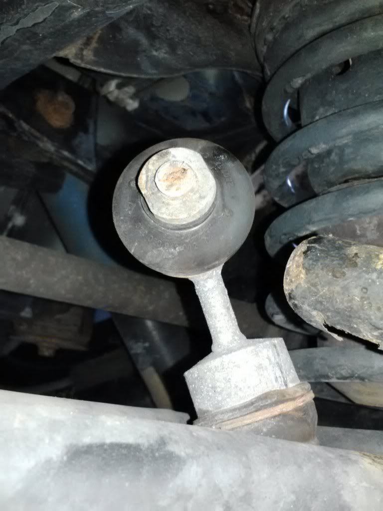

As to the issues I was experiencing the rear anti-roll bar end links had a tendency to break. Constantly. They weren't designed to handle the increased torsional loading due to the higher rates on the bigger bars.

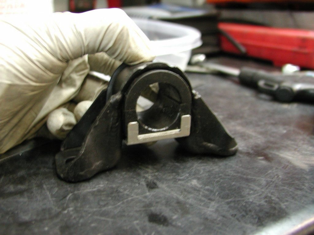

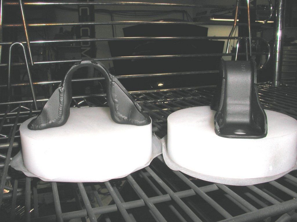

Originally the front ARB's were too long and they hit the half-shafts - I had the company make a second set that were a little shorter that didn't hit. Also the front ARB brackets were an issue for the company I contracted because evidently (according to them) they did not know how to make brackets that weren't the same height as the ARB bushings. They had to give me 'smaller' bushings that fit in the stock ARB brackets and I had the brackets strengthened with some extra material to stand up to track use.

The bar would snap the threaded portions of the rear ARB end links off due to increased forces involved. I'm currently looking at other options for the next car.
I broke both the front sway bar brackets and had some stock ones beefed up to handle the increased forces.

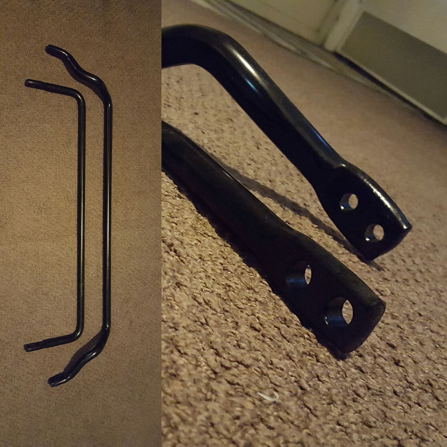

I don't have too many pictures but you can see from this picture that both arms have 2 mount holes for soft or stiff.
