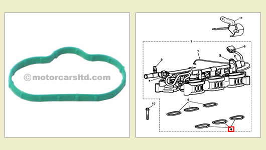

-Change out all 12 gaskets on the intake. 6 below and 6 above the fuel rail below the intake manifold
-Change out the IMT valve gaskets
