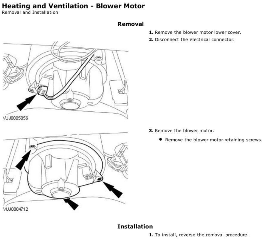

I have not done this but the entire instructions from the workshop manual are to remove cover, remove the electrical plug and 3 retaining screws. If you can see the connector but not the 3 screws maybe there is a plastic cover that has to be removed? Just guessing.

Hey, thanks for the reply! This is actually referring to the HVAC blower motor and does not what I am referring to though I see this confused often. I believe this little part is also called the cabin, air temperature and humidity sensor. If you're sitting at the steering wheel in an LHD version it's right to the right on the dash behind a little 1 in by 1-in grate. I will have to get a picture later and send it.
