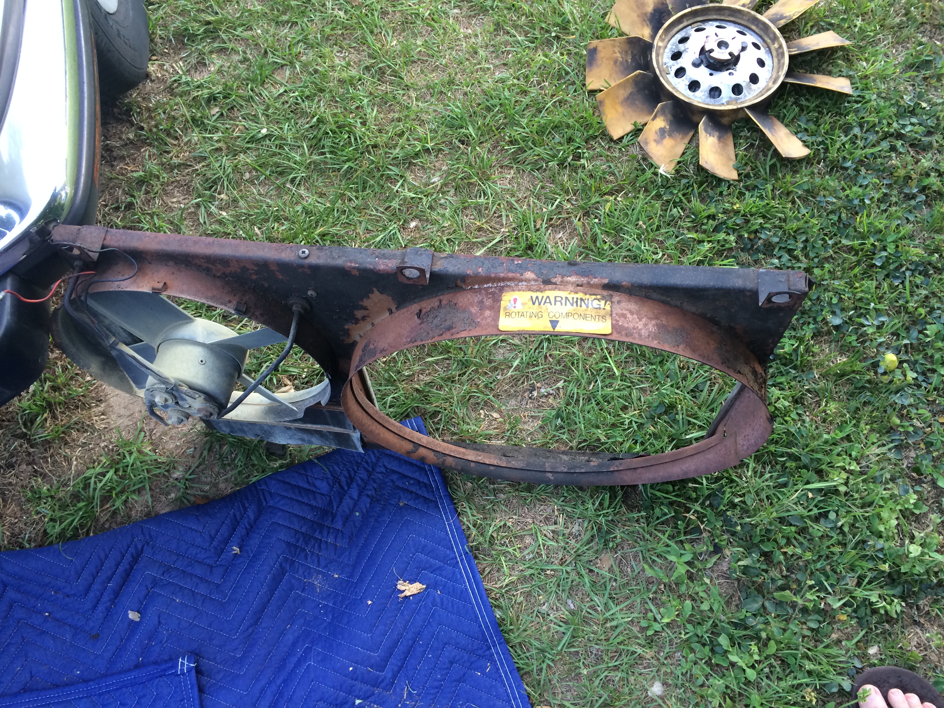

the fan blades hitting the shroud go th th th th th th th th th th very fast
I know... :- )
the bearing in the electric motor... when it dries out screams....
this is what it looked like before putting it back in, it was a rusty mess....
Attached Thumbnails Electric fan "screeching".-u-can-do-.jpg   Electric fan "screeching".-img_0830.jpg
I know... :- )
Had the fan readjusted because it was very nearly, if not certainly, touching the shroud. But a new fan is a good idea anyway (and probably inevitable), so I'll get on that too.
