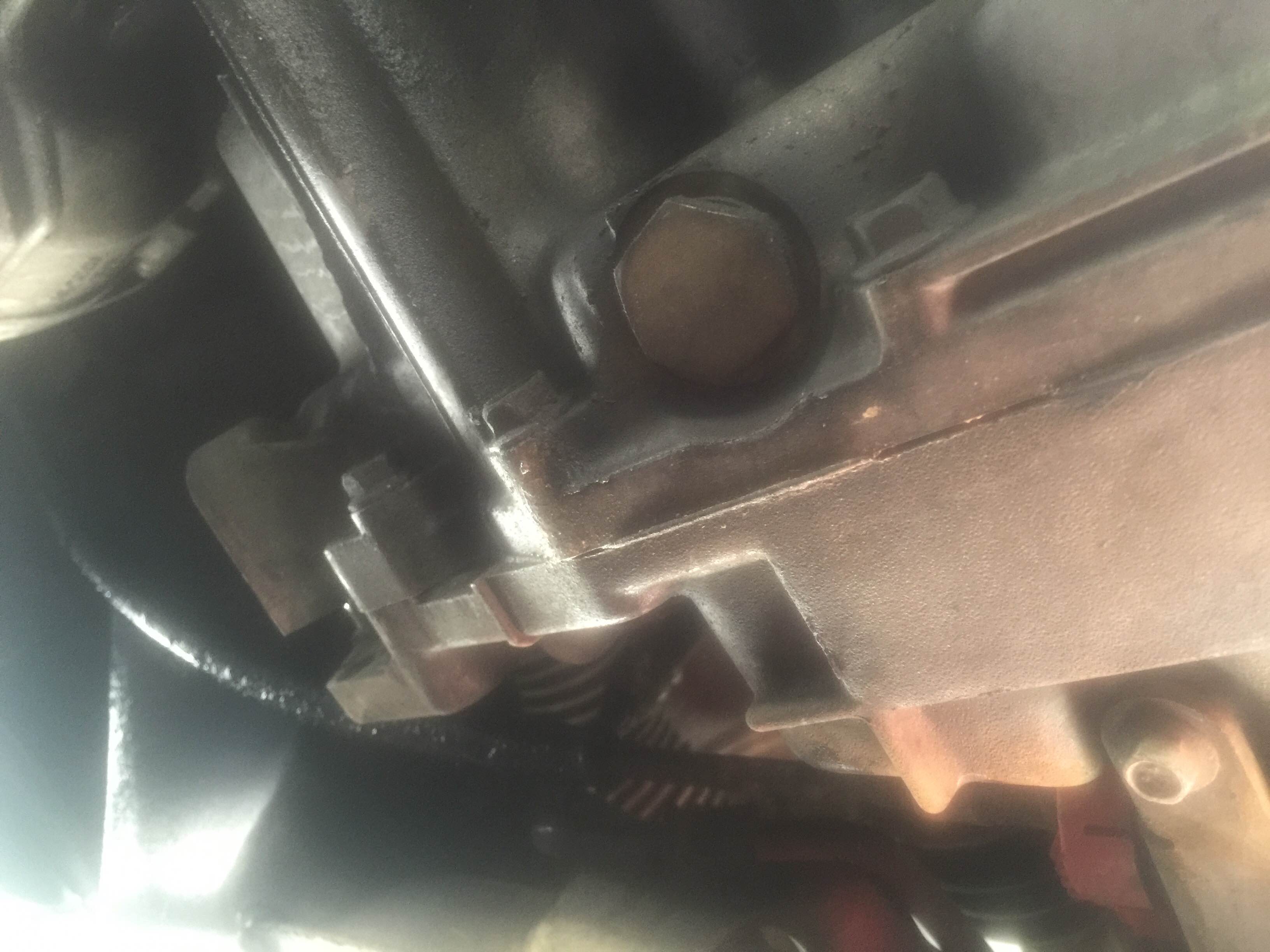

Hi I was wondering if this is the drain plug for the transmission fluid and if somebody could post a picture of the fill hole for the transmission fluid. It's a 2002 jaguar x type.

I have posted a link to a forum thread below that will give you everything you ever wanted to know about transmission drain and fill. The fill plug is just below the battery box. The fluid change procedure requires about 14 quarts and is done in 4 stages. 3.5 quarts at a time

Okay I just looked at that post. Am I in the correct place for the drain plug?

In the picture I posted is that that the drain plug? Anybody?

Yes, that's the drain plug.

Thank you swingwing. I'm going to be changing out the fluid tomorrow after work just wanted to make sure.

Use a 24mm socket for the drain plug. I posted some pictures of my ATF project. Search my posts to see them. I used the 3x drain/fill method with AMSOIL fluid, with excellent results. BTW, you can use the same ATF in the power steering system. Evacuate/refill the reservoir several times until the fluid gets cleaned up.

Thank you! I just located the fill plug too, Thanks to your pictures in your post! Removing the battery makes it easier to get too. thanks again!

There you go. If you have a shallow enough drain pan you won't need to jack the front end up. After you do the first drain & fill the second and third rounds will go much quicker. Don't overtighten the drain plug, as it's not holding back any pressure to speak of. I don't know the torque setting but just snugged mine and it's holding fine with no leaks. You could put on a new crush washer but I reused mine.

Just FYI, read that the torque on the drain bolt is 45nm.
