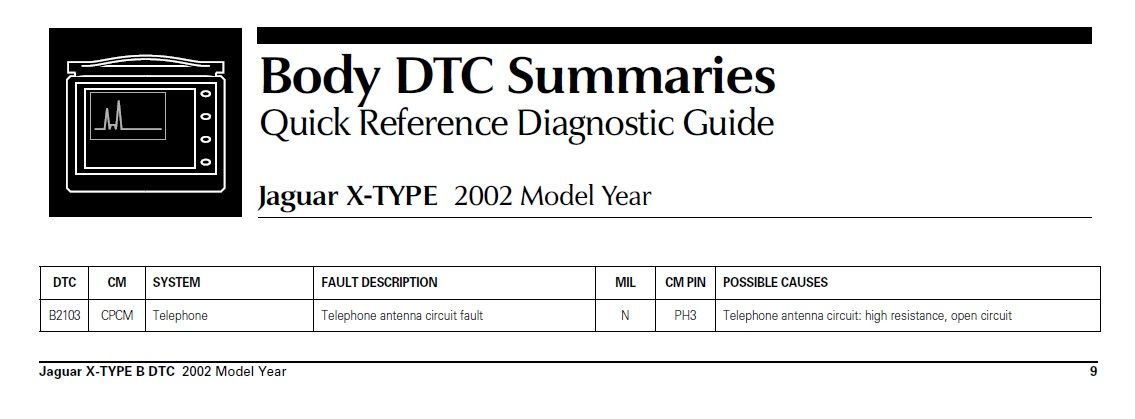

I'm not sure if you read code B2103 with a compatible scantool? If so, this is the relevant decode from the Jaguar DTC lookup:
