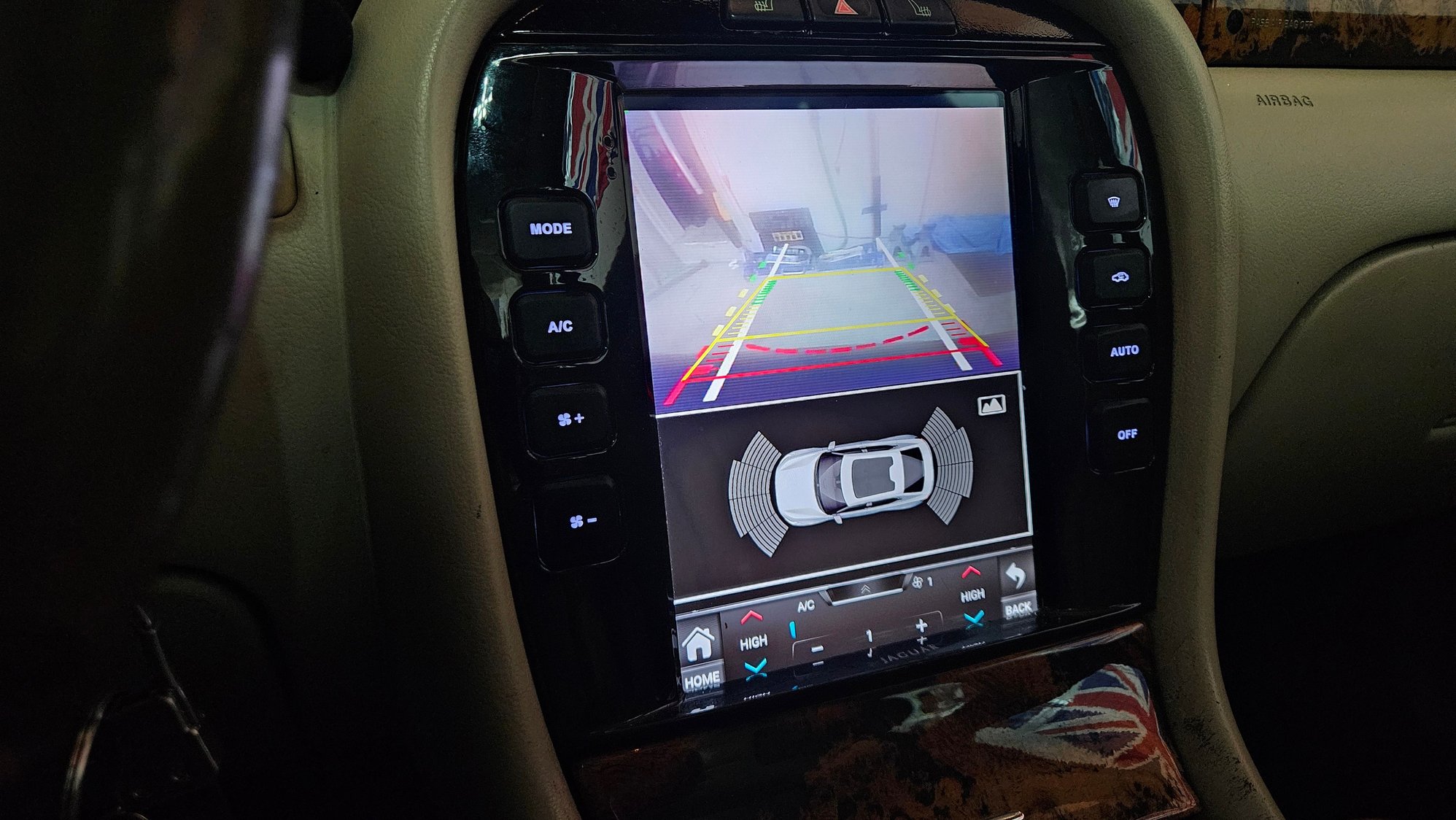

Smile Backup Camera
Does anyone know if it's possible to have a backup camera added to a 2007 X-Type Jag? Also, how to get an updated Navigation disc. Mine is from 2010. Just got the car
Thanks
Old Apr 16, 2024 | 06:47 PM
Yorta2's Avatar
Joined: Mar 2018
Posts: 347
Likes: 117
From: Nowra NSW Australia

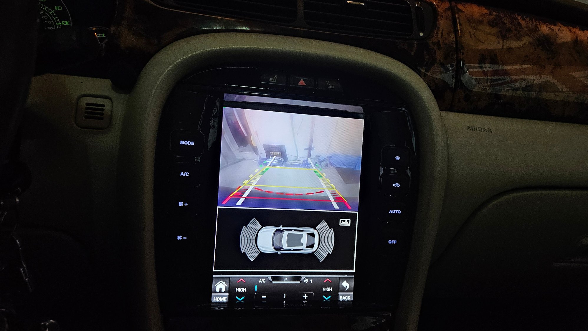

I've got one in my 07 model. I have an aftermarket stereo unit and go a car radio place to put the reversing light kit in, then installed a camera into the licence plate light with help from a camera from AliExpress. First off I got sent one from a later Jag model, so be careful what you order. It works fine. Hope you sort it out. I won't be able to answer any other questions for a month, as I'm off to Thailand today.
