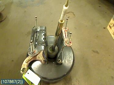

After replacing the brake pads/discs, the brake booster started to behave strangely. When the engine stops, the brake pedal becomes immediately hard. When I start the engine and I push the pedal softly, it becomes hard after 1-2 secs. But when I press it almost halfway, it keeps the vacuum constantly. I checked the hoses and the vacuum generator (I don't know its precise name) and it seems, that it is the Booster, where the vacuum disappears.
I consulted my car mechanic, and he suggested, that though the Booster can be taken apart, it would be more effective to replace it instead of repairing.
So I recorded the ID I found on it (0204024043) and checked ebay.
I found this item POWER BRAKE BOOSTER Jaguar X-Type 2002 02 03 | eBay The picture says the very same ID, but the seller says, that it is "thru VIN D44087". My VIN ID is E59532.
Others say (Jaguar X-Type 2001-2008 Petrol/Diesel BRAKE BOOSTER SERVO **FREE UK DELIVERY** | eBay) that the same booster is OK for my car ("2003-2008 X-Type Diesel (all engines)") but visually it significantly differs from the other one.
Does anybody know exactly which one fits into my car without removing the original one? Is there a difference between the left and right wheel models (concerning the brake booster)?

I upload the picture of each type to make the difference clear:
Attached Thumbnails Brake Booster-booster-1.jpg   Brake Booster-booster-2.jpg   Brake Booster-booster-3.jpg

FYI, I found pictures of a brake booster in the internet, which has the very same ID as mine:
Attached Thumbnails Brake Booster-image1.jpg   Brake Booster-image2.jpg   Brake Booster-image3.jpg   Brake Booster-image4.jpg
