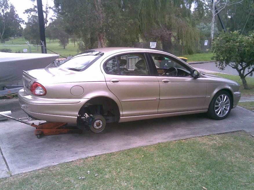

Thanks Matt and Green machine for your suggestions. I've had another go and removed the calipers, lubed the pistons and put the calipers back on but I didn't get time to bleed properly. One of the pistons was a bit stuck but no luck yet. I'll have another go tomorrow, I'm going to get one of those bleeders and once the fluid is correct and the brake pedal feels right I'll check to see if the sensor can be adjusted.
Man, I had no problems with the front pads and discs!
here are pics of the front calipers and one in its jacked up state.
Attached Thumbnails Brake light continuously on after doing back brake pads-08032009a.jpg   Brake light continuously on after doing back brake pads-25022009-001-001a.jpg
