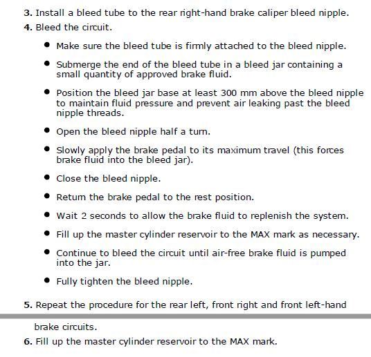

Maybe I misspoke, I didn't bleed both rear brakes at the same time. I bled the rear passenger side, then the rear driver side, then the front passenger side, then the front driver side. Same procedure I have used on a dozen cars, same procedure in the X-Type shop manual (shop manual procedure below). The logic I learned is you bleed the longest brake line first which is why you always start at the rear passenger side. Looking at the Jag lines the rear driver side line is longer. Anyway, that is academic, I bled the brakes per the shop manual procedure. Also I only changed brake lines and flushed & bled fluid so in my mind either I got the air out or I didn't, I don't see how I did anything that causes all 4 brakes to drag.
