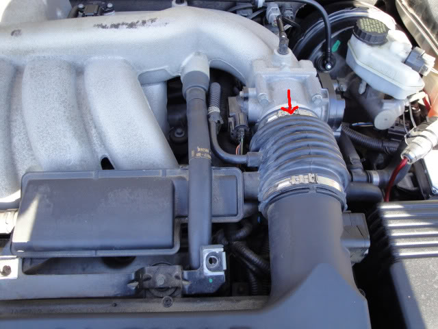

check these areas for vacuum leaks
before you start spending any money
it could be a nuber of things ...but these are the most common
