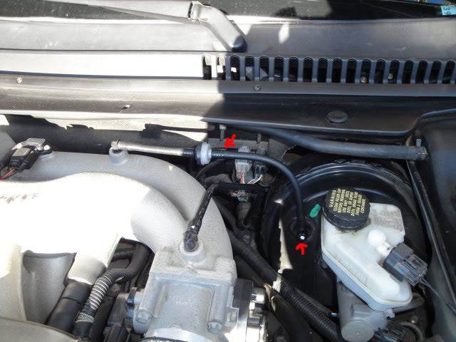

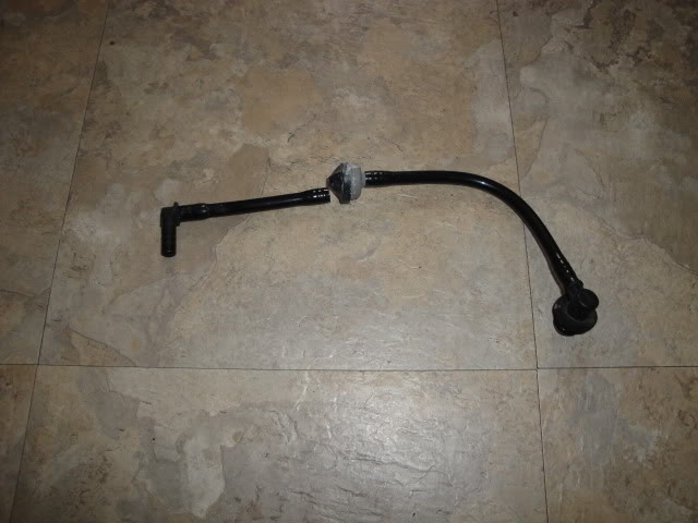

this is the one your talking about from my list wright?
these are basic vacuum problems due to heat under the hood

then all you do is clear the code and your on your way ....happy driving good luck

Dennis Black...yes, that is the one you pointed out.
