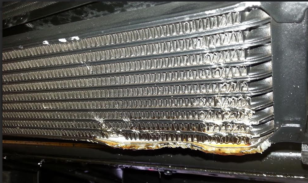

Y'all have been quite helpful, but the mystery of the missing oil was found and it wasn't the dealers fault, apparently there is this wonderful device called an oil cooler located right in front of and near the bottom of the radiator, I ran over something and it damaged the oil cooler........a very short drive later low oil pressure light goes on......engine goes off.......and I get the less than great news that she's dead
According to the dealer, the engine is toast, I have had this beautiful machine for less than 60 days and now this......it literally is making me ill
Any suggestions from here....??
Used engine?
Re-built engine?
New engine doesn't exist
The rest of the car is in perfect shape
Any and all advice appreciated

Shouldn't the oil cooler be protected by the plastic skirt below the radiator?
Old Sep 1, 2015 | 11:36 AM
Jandreu's Avatar
Posts: 2,173
Likes: 605
From: Goldsboro, NC
His oil cooler appears to have been relocated......
