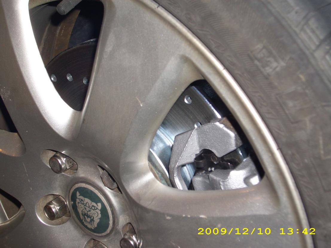

redid my brakes with four drilled and slotted rotors and four sets or ceramic pads. while under there i had to dissassemble and wire brush , and even sand some parts just to clean up. i then painted the caliper brackets, and most of the calipers them selves. did mostly visible parts, lightly though underneath where rotors spin by.(went light because theres about 2 millimeter space either side of rotor before caliper bracket) fronts were not so bad, newer looking pads but rusty rotors and claiper. rears were blown. pads were gone, rotors looked worse then front, and i found that a prior attempt to compress the rotors slightly damaged the grooves. the rear calipers have pistons that must be rotated a certain direction while compressing them. in a half *** attempt to do so, someone else managed to mis-shape the grooves slightly, however i was able to complete the job, and compress them all the way, and even line them up to slide right over the bump on the new pads when installing. i rented the tool and it took all of five seconds to compress each one.
they work great, and look good too, all for under $200
4 sets of pads and four drilled and slotted rotors were $189 on ebay free s/h more (sets availabe search for brakemotive76 )
caliper paint was 8 bucks
-stevis05

yup, smoked a whole can of brake cleaner between the calipers, brackets and new rotors. the pic makes the rotor look greasy, but its because i changed the pads and rotors on the fronts, and refitted everything without new paint friday night then drove like 20 m. sat morning i got the paint and took the fronts back apart to repaint, thats why theres lines on the rotor. around the lugs is synthetic green grease, cause i had to kick the wheels of the car. post a pic of the finished product if you can. regards -stevis05
