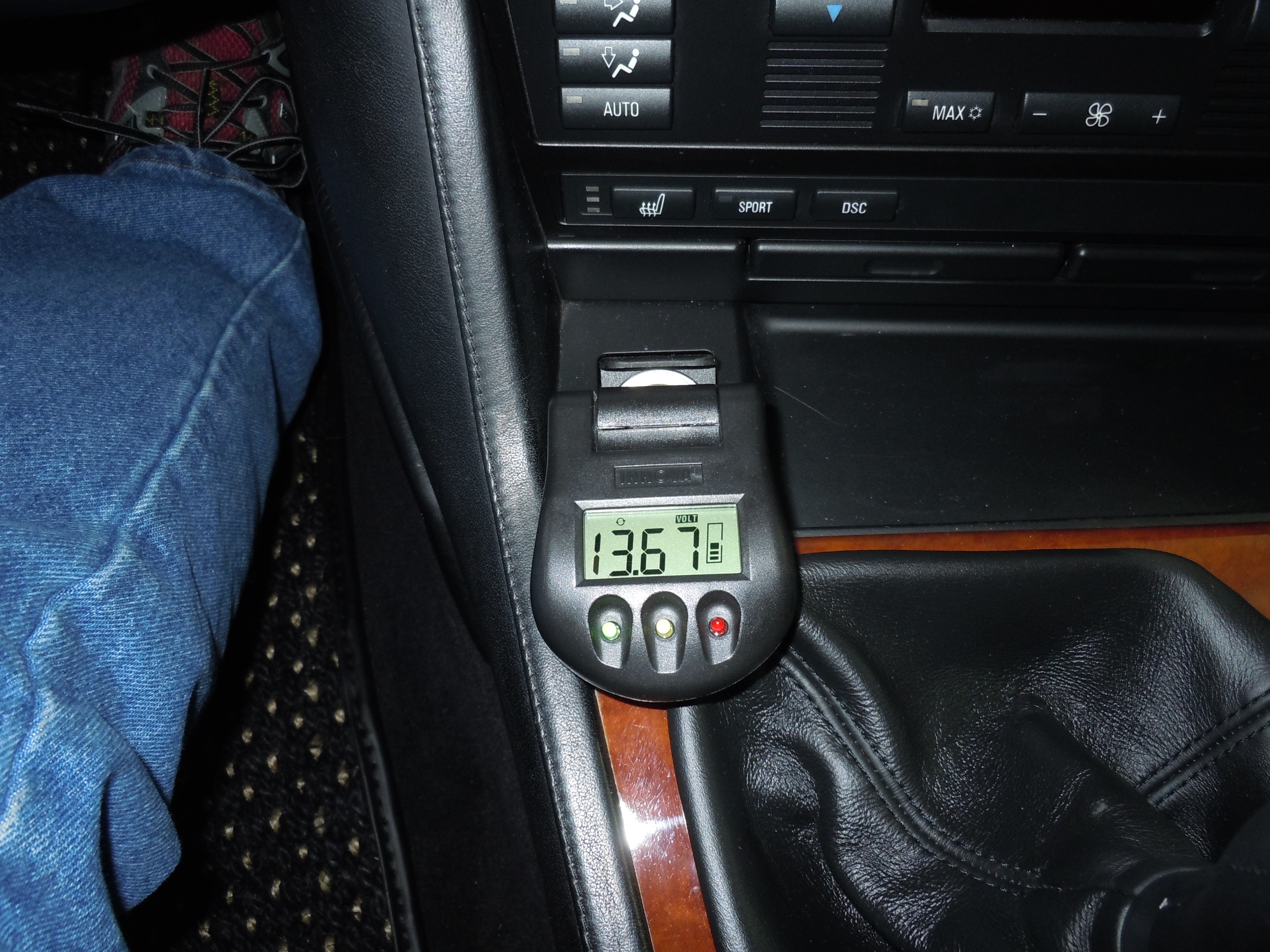

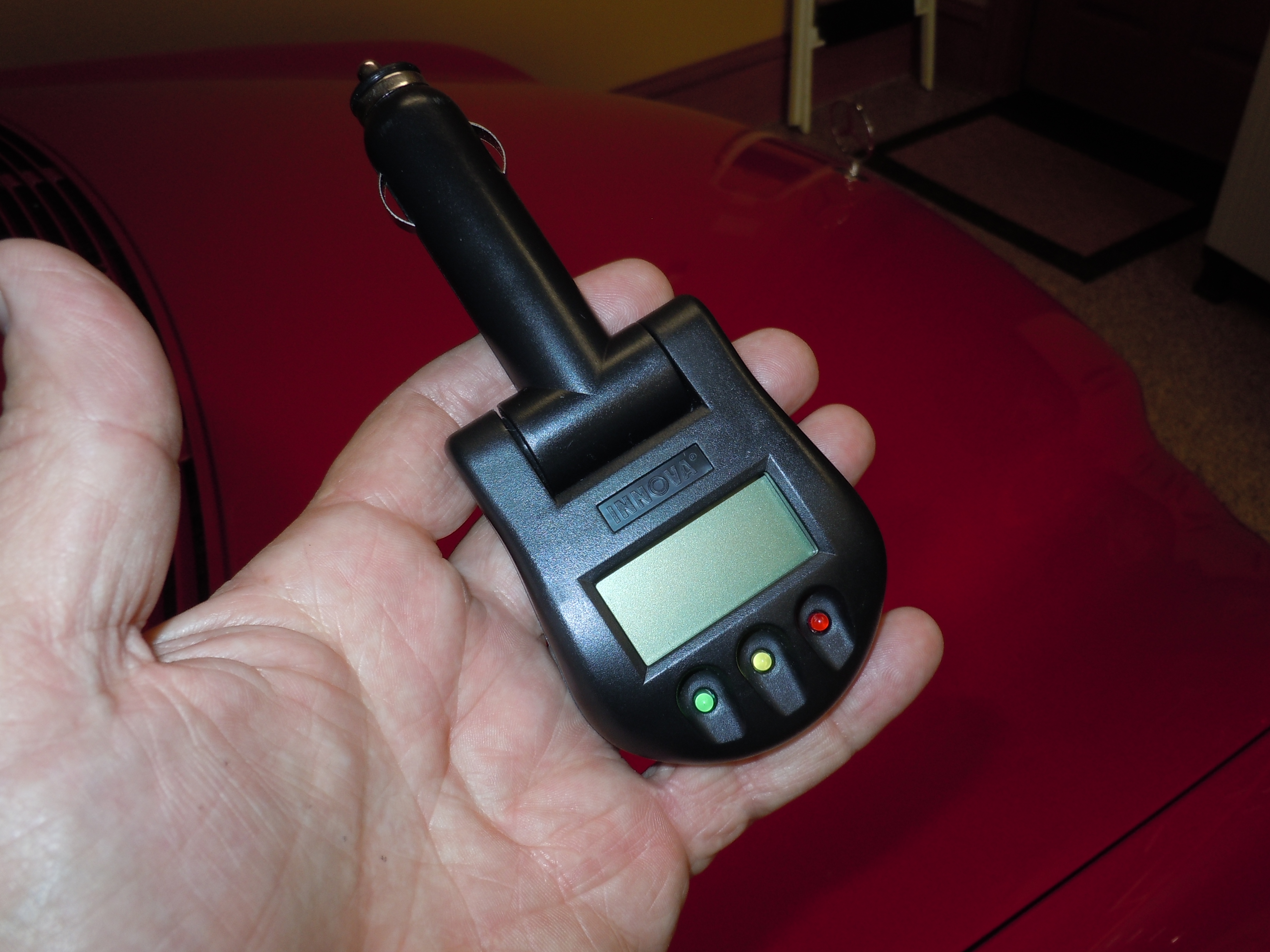

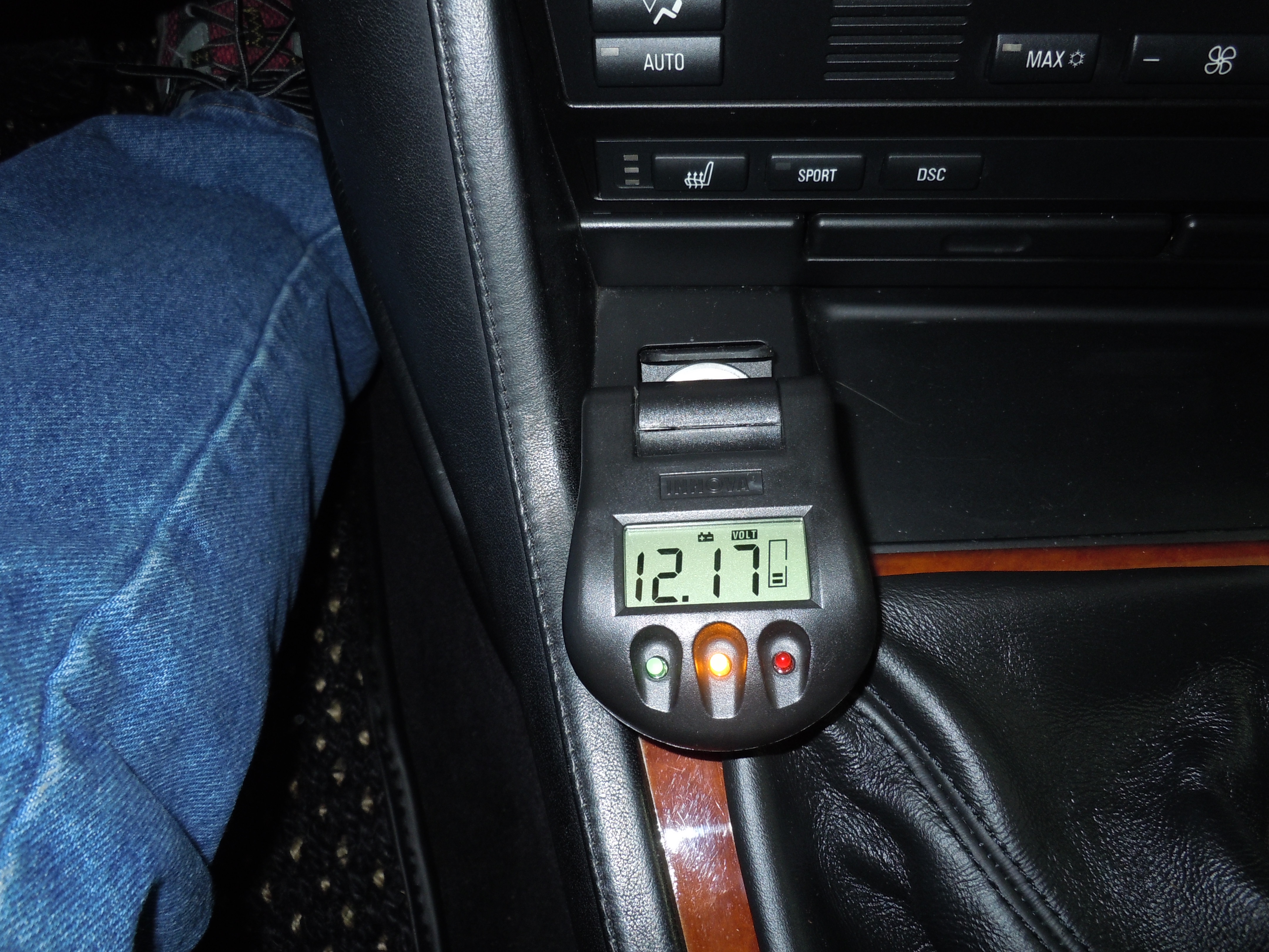

Gary, you may have condition called parasitic drain from some component on the car that's supposed to "go to sleep" after shutdown but is staying on. You can search YouTube for some videos on how to find the culprit. I recommend you test your battery and alternator with a multimeter, or one pictured that's easy to see from inside car. Static battery voltage should be 12.6v when fully charged. When engine's running you should see approximately 14v. Second picture shows my M5's battery voltage slightly low (car sits a lot), but all's well in third picture with engine running. If you use a multimeter measure at the battery posts, not the cables.
